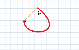

I need to give the user the option du create a curvedConnection that looks like a three quarter circle.
We also did this for the quarter and semi circle without problems.
Here is what we did to draw the semi circle:
We use the method Graphiti.getPeCreateService().createCurvedConnection(double[] controllPoints, Diagram diagram).

for this curve we create a solid polyline.
The result is as following
I tried some approaches like setting two additional points for the three quarter circle that move the line backwards or the following idea with 4 controllpoints like it would be drawn in a normal coordinate system

What I want is something like that (Hard to draw it in paint but you know what I mean^^)
what I get is always a scary form like that
I think the editor has a hard time to draw in negative x direction. Is there any approach to resolve this issue and draw forms like a three quarter circle?
