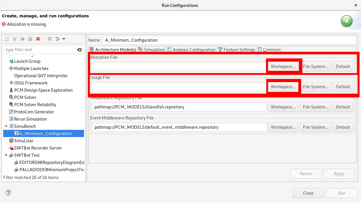

No problem so far. Now have a look at this image, pls:
index.php/fa/34816/0/
I need to set some text in the highlighted text fields, but SWTBot is not able to find/access them. It seems like it would be only possible to use "structures" that are not within these tabs ("Architecture Model(s)", "Simulation", etc.). The next problem is, that I have to switch to the "Simulation"-tab, to fill out another form.
Is it somehow possible to access the "structures" (buttons, text fields, ...) inside these tabs as part of a SWTBot test? If so, please tell me how. (I assume that if you can give me an example that works on the run configuration of a "normal" eclipse project, the same strategy should work in my case as well).

Hi N M,
I would expect to access these widgets with code similar to this:
        SWTBot shellBot = bot.shell("Run Configurations").activate().bot();
        shellBot.cTabItem("Architecture Model(s)").show();
        shellBot.buttonInGroup("Workspace...", "Allocation File").click();
        shellBot.textInGroup("Allocation File").setText(text);
Please let us know if this solves your issue or if you find another solution. If it doesn't work, what error are you getting instead?
Patrick
