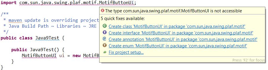

But eclipse shows problems (the type xxx is not accessable).

To avoid these problems i can modify the project configurtaion:
Java Build Path -> Libraries -> JRE System Library [JavaSE-11] -> Is modular -> Edit
BUT: m2e is controlling the project settings. maven update command removes the changes in the project settings every time.
Is it possible to enable m2e to take over the vm-args from the pom to the project settings?

Sounds like an excellent question for the m2e experts.
Please find their coordinates in https://www.eclipse.org/m2e/m2e-community.html
Or as a workaround: avoid executing "Maven > Update Project" after initial import, at least that part that changes the project configuration.
Re: Eclipse - Maven - JPMS [message #1801487 is a reply to message #1801168] Mon, 21 January 2019 02:30 Go to previous message
Ok, thanks . Hiere is the releated bug report: https://bugs.eclipse.org/bugs/show_bug.cgi?id=543631
