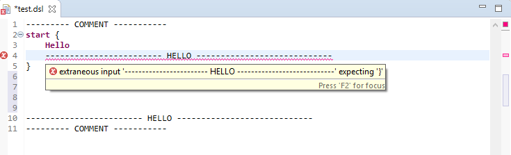

Yes, it worked. Thank you very much!
I have another question, if you wouldn't mind.
My Grammar looks like below: -
Model:
	(test+=Test)*
//OfflineExpressionParser
Test:
	Comment | Exp | MainExp
Comment:
	comment=COM
Exp:
	exp='Hello'
MainExp:
	'start' '{' (Exp=Exp)+ '}'
terminal COM:
	( '---' ('-')+ (' ') (('A'..'Z'|'0'..'9')+ (' '))+ ('-')+ )
Now, when I try the 'Comment' rule in the runtime, the resulting responses are given in the attached image.
Could you please tell me the reason for the Comments to be recognized/not recognized by the program at different instances?
I tried modifying the grammar as below, but it gave the same results: -
Model:
	(test+=Test)*
Test:
Comment:
	comment=COM
Exp:
	exp='Hello'
MainExp:
	Comment | ('start' '{' (Exp=Exp)+ '}')
terminal COM:
What if I wanted for the program to recognize Comments anywhere in the file? Could you please tell me how I could modify the grammar?
Regards!
[Updated on: Mon, 24 December 2018 03:33] by Moderator
Re: Error in Rules [message #1800329 is a reply to message #1800311] Mon, 24 December 2018 11:35 Go to previous messageGo to next message
Your grammar does not allow comments in Exps.
Ed Willink
Re: Error in Rules [message #1800337 is a reply to message #1800311] Mon, 24 December 2018 16:13 Go to previous messageGo to next message
P J wrote on Mon, 24 December 2018 03:32
What if I wanted for the program to recognize Comments anywhere in the file? Could you please tell me how I could modify the grammar?!
The easiest way to have comments anywhere is to hide them just like whitespace. e.g
grammar org.eclipse.ocl.xtext.base.Base hidden(WS, ML_COMMENT, SL_COMMENT) //with org.eclipse.xtext.common.Terminals
The hidden comments are recoverable from the leaf nodes of an Xtext Node element.
Ed Willink
