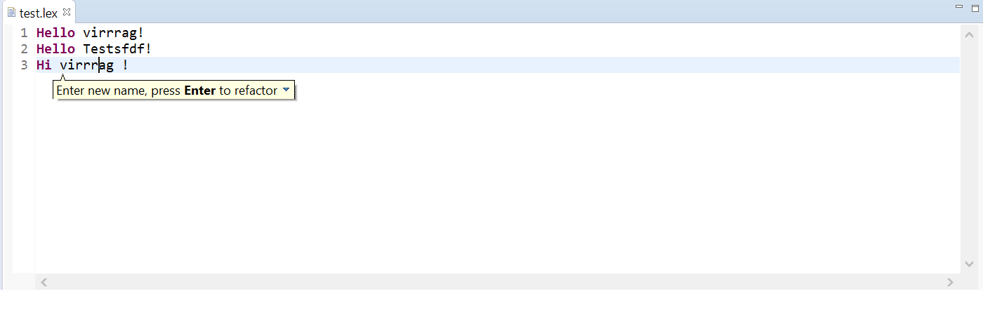

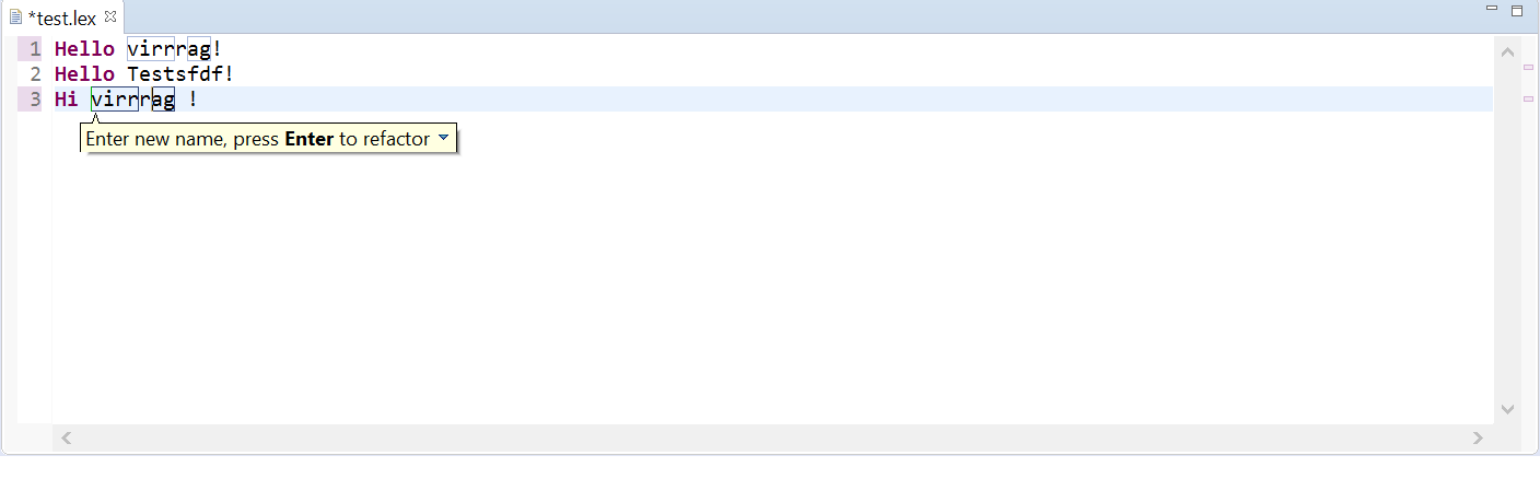

Please refer the uploaded files. On press of enter button it is not coming out.
Could you please let me know that what can be the problem ?

Re: Element Rename in XText 2.14 [message #1798298 is a reply to message #1798297] Thu, 15 November 2018 00:43 Go to previous messageGo to next message
Do you mean enter key?
Re: Element Rename in XText 2.14 [message #1798301 is a reply to message #1798298] Thu, 15 November 2018 01:52 Go to previous messageGo to next message
Yes. But I found the problem.
There was small problem in overridden class from RenameRefactoringController.
