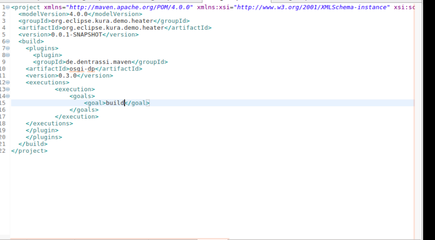

Yes i have added the maven dp pulgin to pom.xml
<plugin>
<groupId>de.dentrassi.maven</groupId>
<artifactId>osgi-dp</artifactId>
<version>0.3.0</version>
</plugin>

Re: Generate dp file [message #1797034 is a reply to message #1797029] Wed, 24 October 2018 06:22 Go to previous messageGo to next message
as the error states, there is an error in your pom file.
Maybe have a review on maven documentation to get rid of it.
Matteo
Re: Generate dp file [message #1797090 is a reply to message #1797034] Thu, 25 October 2018 01:43 Go to previous messageGo to next message
Thank you now i am able to created dp file through the goal
<goal>build<goal>
