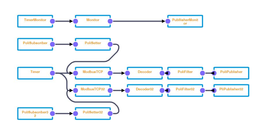

Re: Constant growth of memory [message #1796585 is a reply to message #1796345] Tue, 16 October 2018 06:50 Go to previous messageGo to next message
cat /etc/os-release
PRETTY_NAME="Raspbian GNU/Linux 7 (wheezy)"
NAME="Raspbian GNU/Linux"
VERSION_ID="7"
VERSION="7 (wheezy)"
ID=raspbian
java version "1.8.0"
Java(TM) SE Runtime Environment (build 1.8.0-b132)
Java HotSpot(TM) Client VM (build 25.0-b70, mixed mode)
kura_3.2.0_raspberry-pi-2
We use some custom ConfigurableComponent, (like signal filter), and custom pubisher (in order to modify the output message) but we are reasonably sure that we have not created code that can generate memory leaks.
  • Attachment: Cattura.JPG
    (Size: 47.40KB, Downloaded 127 times)
