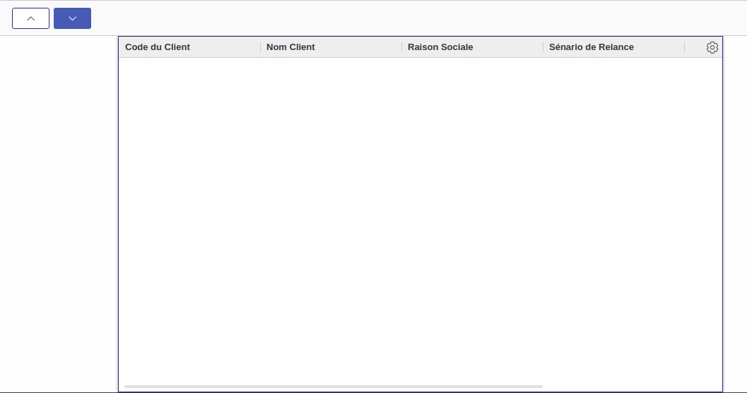

I would like to know how I can make the form appear on all the nodepage.
I made a NodePage in with I added a Form
protected Class<? extends IForm> getConfiguredDetailForm() {
// TODO Auto-generated method stub
return CustomerForm.class;
How to make the form appear on all the Page and not like in the screenshot.
Kind Regards

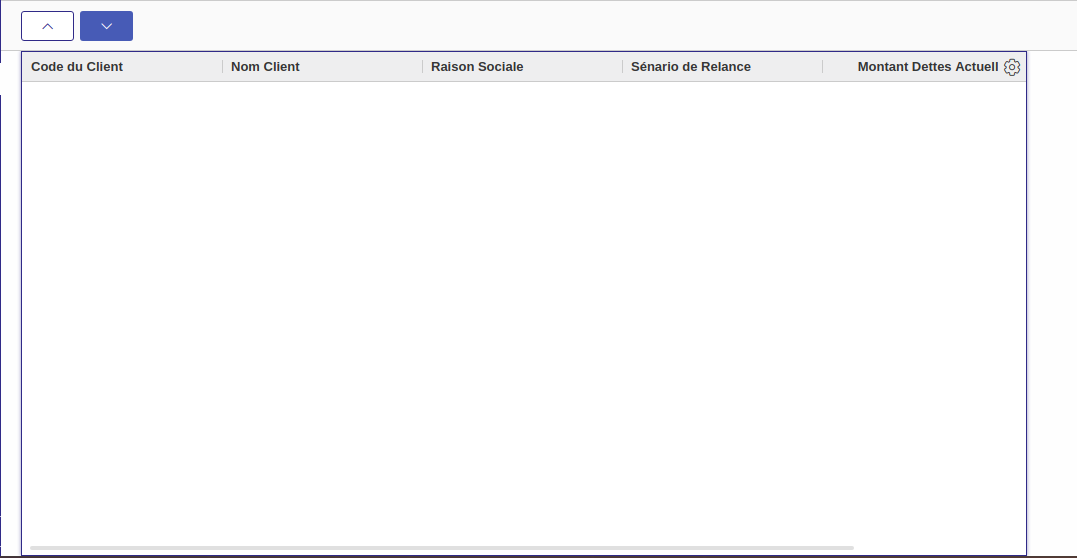

Hello
I already removed that space using the LabelVisible as you said, but there still some space, please take a look on the screenshot Form.png
How to remove the right and Left spaces ?
Kind Regards
  • Attachment: Form.png
    (Size: 11.90KB, Downloaded 97 times)
Re: Fill Horizontal Form [message #1795979 is a reply to message #1795976] Wed, 03 October 2018 09:21 Go to previous messageGo to next message
If you only want to display a table, you should use an AbstractPageWithTable instead of a form containing only a table (see for example Persons table in https://scout.bsi-software.com/contacts).
For the node page with form, you may try to use getConfiguredStatusVisible to reduce the space on the right side. For what is left, you probably need to use CSS, but I wouldn't recommend that.

I know there is a specific Page for Tables but lets change the Table to a CalendarField, the only way is to use NodePage I guess, and then we would like to get all the Calendar fitting to the Page.
Kind Regards
