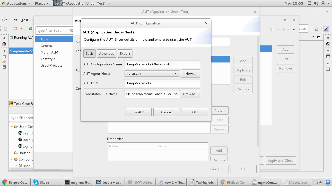

Trying to configure an AUT which is a JNLP.
This is an swt based applicationindex.php/fa/33933/0/
1. JNLP is downloaded to the below mentioned path /home/meghana/Desktop/jubula_8.6.0.262/examples/AUTs/mgmtConsole
2. The same path has a shell script which invokes the jnlp using javaws command
3. On clicking "try AUT ", below error is thrown
5009: AUT start failed
Establishing connection to AUT failed.
Please check the AUT configuration. AUTServer could not start: Unknown AUTServer exit code: 31.
Picked up _JAVA_OPTIONS: "-javaagent:/home/meghana/Desktop/jubula_8.6.0.262/ite/plugins/org.eclipse.jubula.rc.common.agent_6.0.0.201802230740.jar"

Hello Meghana Iyer,
Jubula does not support JNLP as a startable application[1]. The problem is that the e.g. the javaws application which is started first is seen as the AUT which should be tested. That why jubula is than Missing SWT classes because this application is not a SWT one. The only possibility is to start the downloaded application and not to start it over the JNLP.
best regards
Marvin Mueller
[1] https://testing.bredex.de/faqs/can-jubula-test-java-web-start-applications.html
