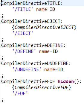

The basic layout is:
'/' directive (directive_options)?
My one of my initial attempts:
>>Insert Screenshot of Grammar Snippet<<<
CompilerDirectiveTITLE:
'/TITLE' name=ID
CompilerDirectiveEJECT:
{CompilerDirectiveEJECT}
'/EJECT'
CompilerDirectiveDEFINE:
'/DEFINE' name=ID
CompilerDirectiveUNDEFINE:
'/UNDEFINE' name=ID
CompilerDirectiveEOF:
{CompilerDirectiveEOF}
'/EOF'
The issue::
When trying to specify the "EOF" directive, the grammer does not compile.
>>>Insert Screenshot of EOF directive<<<
'/EOF'
>>>Insert Screenshot of MWE2 Error<<<

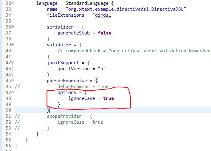

Parser.g:104:3: The following alternatives can never be matched: 2
Request:
Is it possible to have '/EOF' in the DSL?
