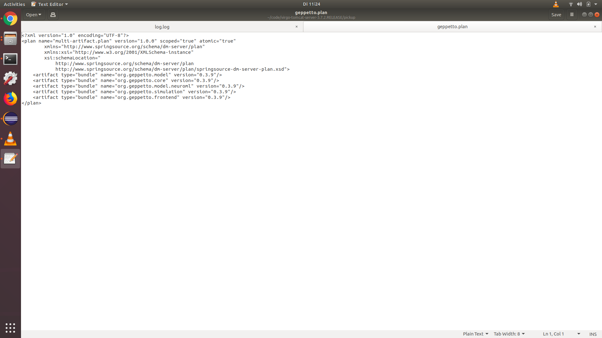

The pickpup plan I'm using looks like this:
index.php/fa/33500/0/
The artifact that's causing the problem is the last one, org.geppetto.frontend. If I remove it from the plan, and then go to http://localhost:8080/admin/content/artifacts and manually deploy the artifact from there, I don't get the error.
Any ideas on what's going on are much appreciated !
Re: Multiple spring deployments on Virgo 3.7.2 [message #1792970 is a reply to message #1792911] Thu, 26 July 2018 12:09 Go to previous messageGo to next message
your plan is scoped [1] and this may explain why you have a different behavior when you remove the front end bundle from the plan and deploy it separately.
Artifacts in a scoped plan are deployed as a "whole" and the requirements of a bundle in a scoped plan are resolved against the capabilities of other bundles in the same plan.
The uses conflict normally arises when two bundles depend on different versions of the same package and a third bundle depends on both and reaches via its dependency tree the two different versions of the same package.
Please check:
- all of your bundles require the same version of the Spring packages
- that none of your bundles by mistake declares to export a spring package
- that you did not add another version of the spring bundles to a virgo repository folder
Could you also try to make the plan not scoped and see what happens?
GianMaria.

Thanks for the feedback.
I tried making my plan not scope but it didn't work, I still get the same result.
This is how my plan looks now.
<plan name="multi-artifact.plan" version="1.0.0" scoped="false" atomic="true"
        xmlns="http://www.springsource.org/schema/dm-server/plan"
        xmlns:xsi="http://www.w3.org/2001/XMLSchema-instance"
        xsi:schemaLocation="
            http://www.springsource.org/schema/dm-server/plan/springsource-dm-server-plan.xsd">
    <artifact type="bundle" name="org.geppetto.model" version="0.3.9"/>
    <artifact type="bundle" name="org.geppetto.core" version="0.3.9"/>
    <artifact type="bundle" name="org.geppetto.model.neuroml" version="0.3.9"/>
    <artifact type="bundle" name="org.geppetto.simulation" version="0.3.9"/>
    <artifact type="bundle" name="org.geppetto.frontend" version="0.3.9"/>
</plan>
I double checked and all the bundles are using spring 4.3.9 . The spring bundles that are in virgo's repostitory folder "usr" are also 4.3.9, same version than the ones in virgo's repository "ext" folder, except that the ones in "usr" are not OSGI bundles and come directly from maven.
Looking at the Manifest file for the org.geppetto.frontend bundle, I do see some references to spring packages from the export-package section.
Should these not be there?

Re: Multiple spring deployments on Virgo 3.7.2 [message #1793054 is a reply to message #1793009] Mon, 30 July 2018 06:28 Go to previous messageGo to next message
in my Virgo 3.7.2, spring Jars are located in repository/ext and in plugins, I don't have them in repository/usr. Those in repository/ext and in plugins have OSGi metadata. If you have the same Jars in repository/usr you should delete them.
Your MANIFEST export-package looks okay, because the spring packages show up in the "uses" directive.
However, your imports do not specify the version of the spring packages, so I would suggest to get rid of the Jars in /usr and to specify the spring version in the imports.
