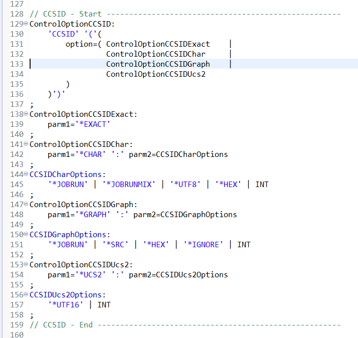

I would like to write a case insensitive grammar that is able to parse Control-Specification Keywords as defined by IBMs website.
BUT... I am having difficulties correctly defining the CCSID control option as defined by IBM. Refer screenshot.
index.php/fa/33473/0/

Please help update the grammar to be able parse the code snippet above. The issue is with the ControlOptionCCSID rule not being correctly defined. :(

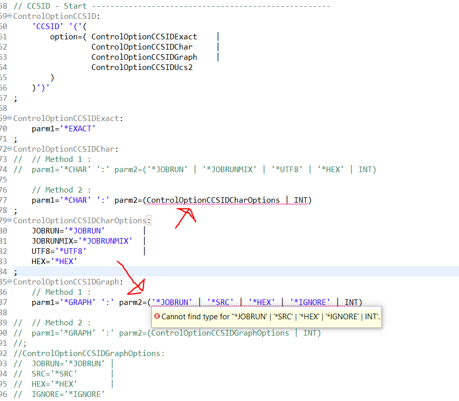

did you consider to introduce datatyperules instead of rulecalls in assignments
.... someAttr=THINGY .....;
THINGY: 'A'|'B'|INT;
and it is not possible to assign primitives and objects to the same thing
objectChild=SomeRulesThatProducesAnEObject | attrChild=INT
Re: RPGLE - Keyword Parsing [message #1792682 is a reply to message #1792664] Sat, 21 July 2018 05:23 Go to previous messageGo to next message
Thanks for the feedback.
The changes allowed the grammar to "compile", updated code snippet.
index.php/fa/33476/0/

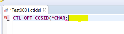

But... prompting in the ecplise runtime workspace is not working. As I would expect (or hoped).
When trying to prompt for the "yellow" highlighting Nothing happens.
index.php/fa/33477/0/

1) Did I do the update to ControlDSL.xtext correctly?
2) Is the prompting and "issue" or is it the expected behavior, and it should be handled via code?
Thanks.

no i am not going to work with your actual grammar. i am just giving hints. if you question is about content assist:
you need to implement content assist for datatype rules yourself by overriding the complete_XXXX method in the proposal provider
