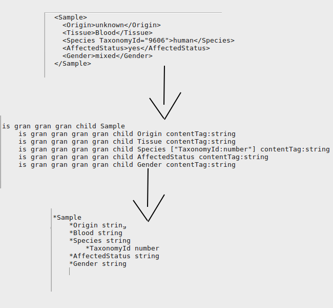

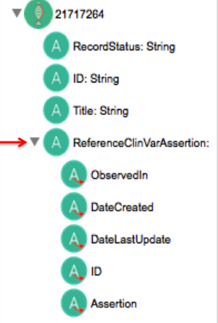

I'm looking at Xtext to create a model of a scheme from an xml file. I was able to extract the xml's structure using Ruby with the gem Nokogiri. Now I have a txt file that tells me all the attributes and types of xml tags. I need to transform this file into a model that follows the attached image.
However, when trying to generate the nested structure I need I'm getting the error:

This is what I would like to do:
index.php/fa/33426/0/
And this is my steps so far:
index.php/fa/33425/0/
Step 1 - Get the xml
Step 2 - Extract xml's structure
Step 3 - Create a grama for generates model with the result from Step 2
Thanks a lot.
Re: Help with recursive grammar [message #1792503 is a reply to message #1792431] Wed, 18 July 2018 14:08 Go to previous messageGo to next message
i have doubts this is easily possible.
you basically have a indentation-aware grammar (like python)
with no indentation but the indentation level beeing determined by counting the number of grans.
Maybe you can use the mechanism xtext has for such languages
(https://www.eclipse.org/Xtext/documentation/307_special_languages.html#whitespace-aware-languages) and customize the util that calculates the indentation
(AbstractIndentationTokenSource)
but this is not a beginner task for sure
so maybe we should do some steps back and try to understand what you actually want to solve.
so can you give some more background
(simply getting a model from an xml file can be done by std. emf means)
