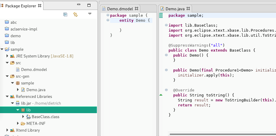

index.php/fa/33308/0/
here is an example
Re: Inheritance from non-grammar java class [message #1791735 is a reply to message #1791729] Wed, 04 July 2018 10:48 Go to previous messageGo to next message
That makes a lot of sense. The generated class should get/know the import too. :D
