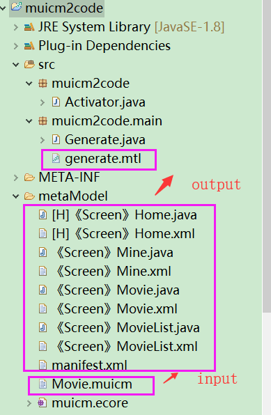

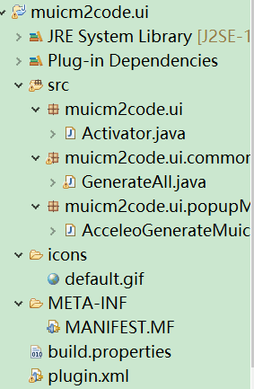

I followed the this link http://wiki.eclipse.org/Acceleo/Getting_Started and created the "muicm2code" and the "muicm2code.ui" projects. I right click the "muicm2code.ui" project, choose "Run as" ->"Eclipse Application ", it run well.

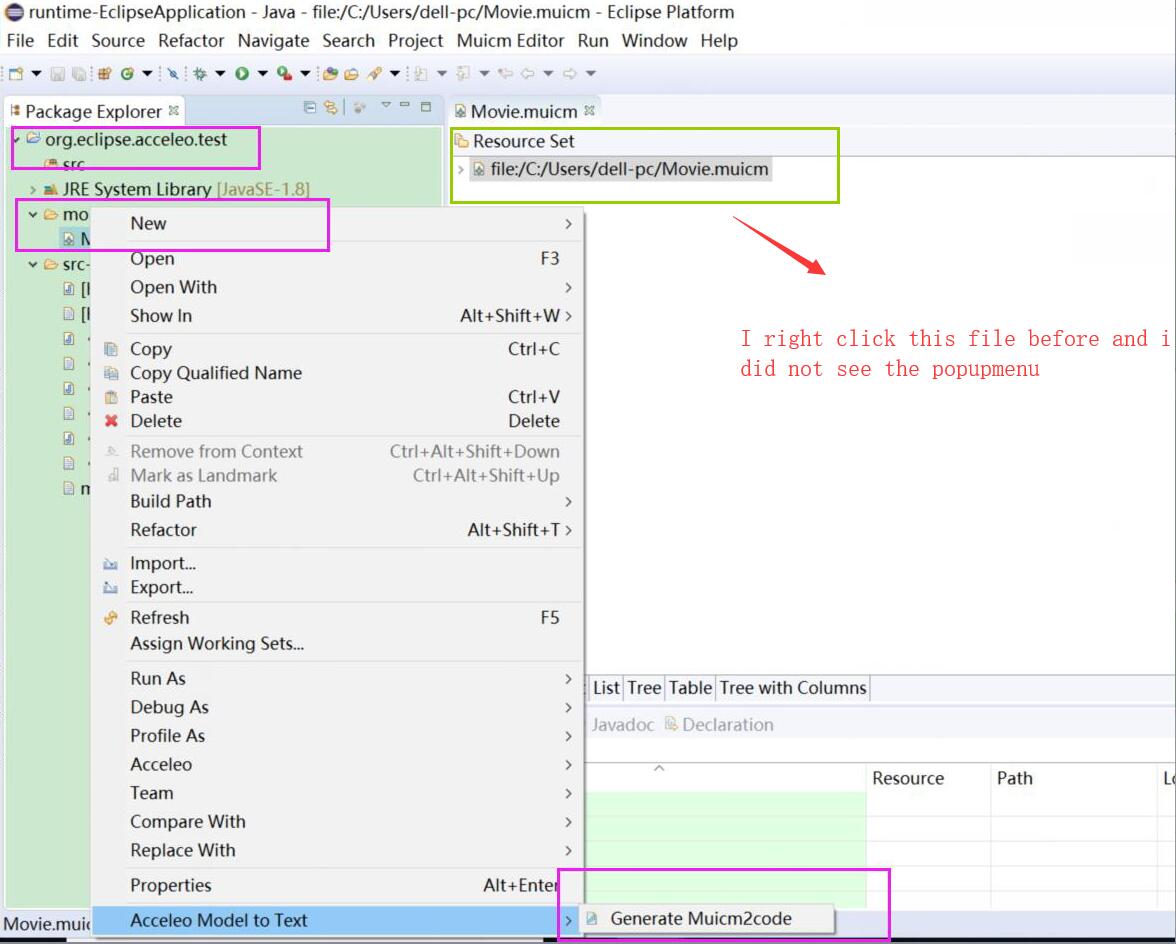

I opend the *.muicm file in this Eclipse Application and i do not find the menu"Acceleo Model to text".when I right click the *.muicm file, I do not find the menu "Acceleo Model to text" too. I do not know why and where to find this menu?
The screenshoots of the "muicm2code" and the "muicm2code.ui" projects and Eclipse Application are uploaded in attachments and two projcets are uploaded too.

The "muicm2code" project

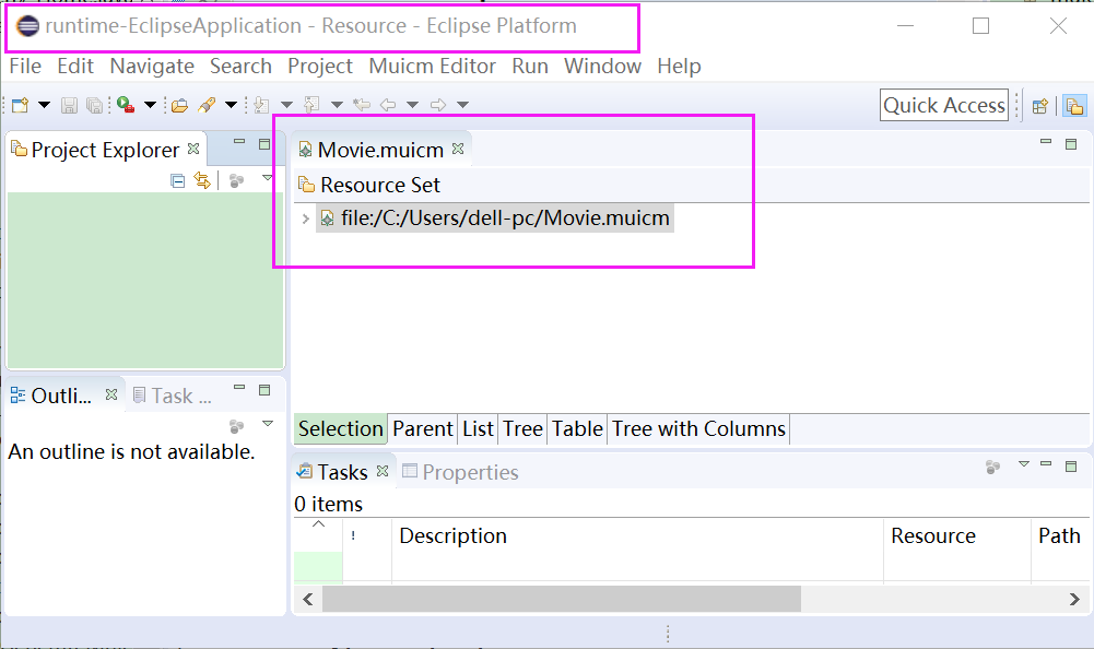

Luckily, I find the PopupMenu by creating a new project and a folder under that project. Then I copy the "movie.muicm" to this folder and right click on the "movie.muicm" , the popup menu"Generate Muicm2code" is shown . The result is as picture4.
  • Attachment: picture4.jpg
    (Size: 93.01KB, Downloaded 249 times)
