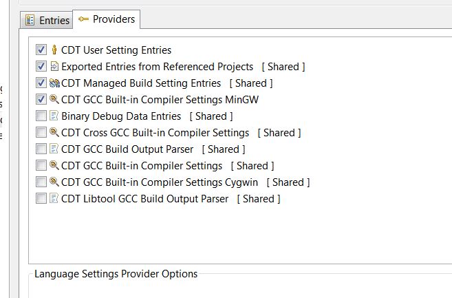

Re: Symbol 'std' could not be resolved Issue [message #1790377 is a reply to message #1790364] Fri, 08 June 2018 14:52 Go to previous messageGo to next message
Provider is all set. I have many other c++ code files that are being parsed correctly. Only the namespace std is the issue.

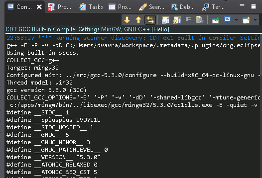

Select the builtin provider then select Allocate console on the Console View
at the bottom of the dialog
You may need to unselect the builtin provider and reselect it before pressing Apply
You may also need to rebuild the index
You should get something like this.
If not try running the command in a windows command terminal.

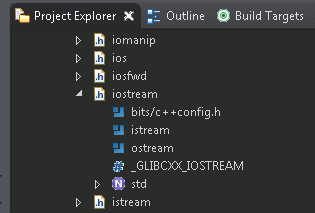

And in Project View under one of the include paths
Note the entry for std in <iostream>
index.php/fa/33064/0/

Re: Symbol 'std' could not be resolved Issue [message #1790468 is a reply to message #1790387] Mon, 11 June 2018 08:41 Go to previous messageGo to next message
I checked everything you showed in your post and I have the same thing. I attached mingcw CDT compiler settings output
