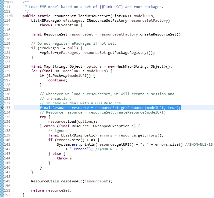

Thanks for looking into the code. With the proposed changes I was able to get the example running.
However, on my real case code it still does not work. I went done with the debugger and found that the method call resourceSet.getResource(modelURI, true) fails. This is called in ResourceUtils.loadResourceSet(...):
index.php/fa/33133/0/
Both, migrateAndLoad() and migrateAndSave() are ending up at this method and, thus, both fail. So migrateAndXXX() throws an exception that the package with the nsURI from the previous model (version 1.0) was not found.
Usually, in my code I use the createResource() method to return the resource:
final ResourceSet resourceSet = new ResourceSetImpl();
Resource resource = resourceSet.createResource(modelURI);
The modelURI is exactly the same in both cases. When I try createResource() directly in my code the resource is returned without any exception. Interestingly, in ResourceUtils.loadResourceSet(...) the createResource() method was commented out. Any reasons for this?
Honestly, I am not sure what the difference between createResource() and getResource() actually is. The context help for getResource() says that: "...the package registry is used to resolve the namespace URI...". Can this be the root cause because the previous model package is not registered?
Thanks and regards,
Gernot.

2. Than it goes to the actual package registry to get the latest version of your ecores. Are both of your emf models registered correctly at the extension point and part of the runtime?
3. Based on the source release it undoes all recorded changes from later releases to get a representation of the ecore which can be used to load the old text file. Here you could check if your history contains all changes, especially ns-uris changes (for earlier release).
4. The loaded file is mapped to a migration model and the miration is done.
I think that since we get an error during resource loading, I think that we have an error during steps 1-3. Could you maybe check that there are two EPackages passed to this loadResourceSet method (base+extension, both should have the original 1.0 ns-uris) and check above comments.
This may help to narrow the problem down.
Cheers
Johannes
Re: [Edapt] Feature not found when migrating [message #1790875 is a reply to message #1790855] Tue, 19 June 2018 09:06 Go to previous message
Hi!
Thanks for the help. Now I got it running. The error was in my example text file but not obvious:
I added an optional attribute manually to test something. However, I did not remember that this attribute was configured as element (FeatureKind=element) in the ecore model. This caused a FeatureNotFoundException while loading that ended up in a PackageNotFoundException for the particular nsURI.
Now, as this is fixed the other problem (parsing my custom EDataType) pops up again, see: https://www.eclipse.org/forums/index.php?t=msg&th=1093606&goto=1790176&#msg_1790176
Thanks for your kind help!
Gernot.
