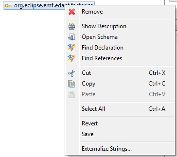

I added the org.eclipse.emf.edapt.factories extension point to my plugin.xml. However, I am not able to add a factory to it. Right-click on the extension doesn't show the "New" menu to add a factory:
index.php/fa/33048/0/
Of course, I can add it to the plugin.xml via the text editor, but it doesn't change anything (i.e. factory is obviously not registered).
Also, clicking the link to the extension point schema causes an error message like: "extension point schema cannot be found".

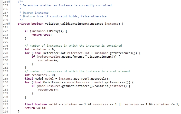

The validation fails when it checks classes that are contained via a feature map in the ecore model. The containment check is done in the MigrationValidator.validate_validContainment() method:
index.php/fa/33193/0/

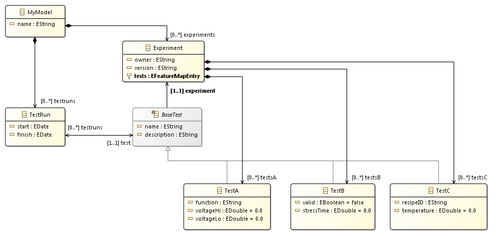

My model looks like this:
index.php/fa/33194/0/
The classes TestA, TestB, TestC have BaseTest as super type. The class TestRun has a bi-directional relation to BaseTest but no containment. The BaseTest - or better - the respective Test* classes are contained by class Experiment via a feature map.
When the valid containment check runs, i.e. TestA is passed as the instance. In line 278 the call instance.getReferences() returns all references from other classes to the TestA instance. Using the debugger I can see that all references from TestRun to TestA are returned. However, none of these is a containment.
Unfortunately, the (containment) reference from Experiment to TestA is not returned. Thus, since TestA is also not directly contained by a resource (lines 284-290) the method finally returns valid=false.
Obviously, the references from feature maps are not considered in this containment check. Bug or feature?
