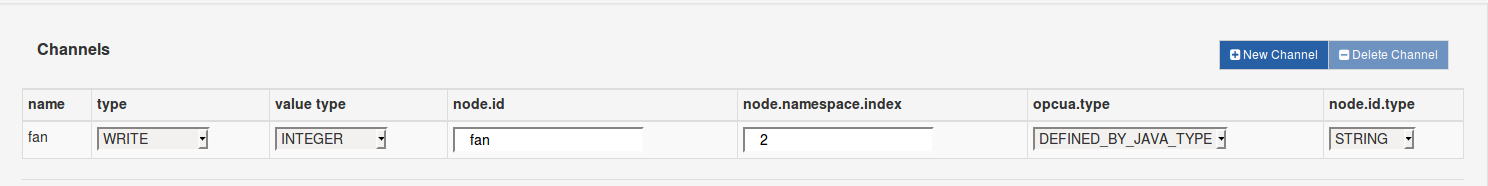

You can find the OPCUA asset channel configs in the attached image.

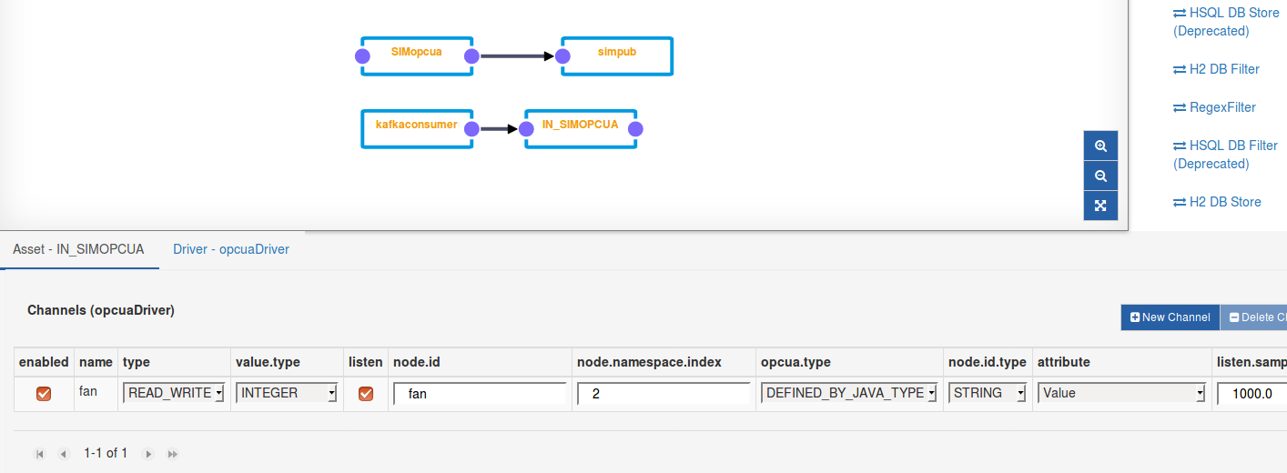

Currently the fan: 1 messages are produced by a kafka topic when a temperature exceed a threshold and they are sent to a consumer which is connected to another instance of the OPCUA simulator asset. (see attached image below).
Care to help me figure this out? Is it possible to write to an asset variable from an external source? If it is, how? Is there any documentation available?

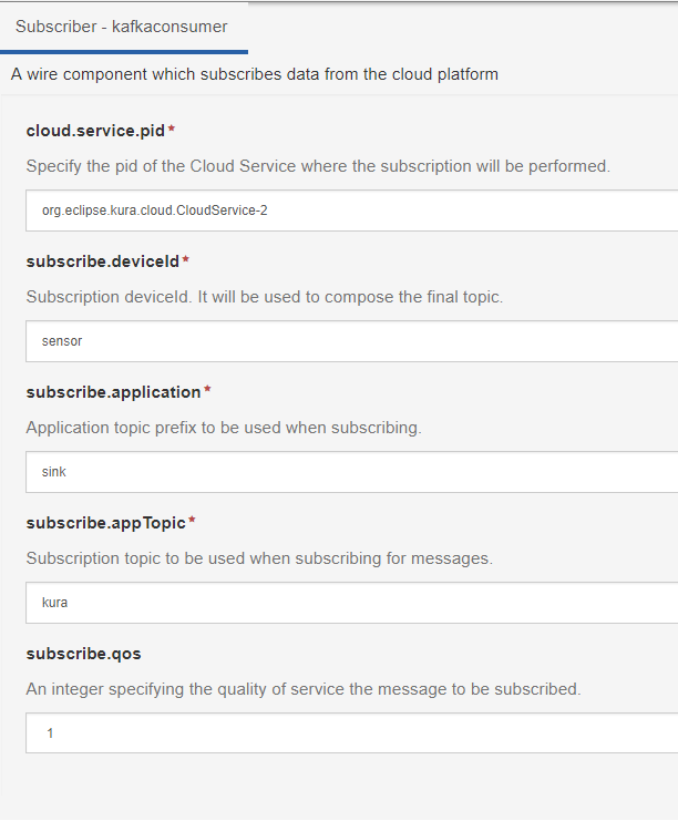

The kafkaconsumer is a cloud subscriber which receives the messages a MQTT topic spawned by a rule. The config can be seen in the attached image.
