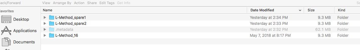

I thought that was the way the hide tags were supposed to work. I opened a spare copy of my most recent code, put them in, took a look in the Design mode while all the Combo box stuff was hidden. I don't recall adding anything in the design mode. I went back to the source mode and hit "run." There are a couple of messages that are set off before the regular screen appears. One is a confirmation that the running program has found the object that makes contact with the database. Another is just a left-over debugging statement that I always forget to track down and delete. Ordinarily it may take a while for these messages to show up, but then when I click through them the actual GUI aspect of the program is manifested almost immediately and I can access data with it, etc. But when I tried running it yesterday afternoon, I just got a blank screen after the database confirmation and the odd debugging message showed up.
I next tried opening the other spare copy of the program, thinking I could just delete the other one since I couldn't figure out what was wrong with it, and I discovered that it was doing the same kind of non-performance. I checked the "date modified" on these two files. One was changed at 2:33 yesterday afternoon, and the other was changed at 2:34.
