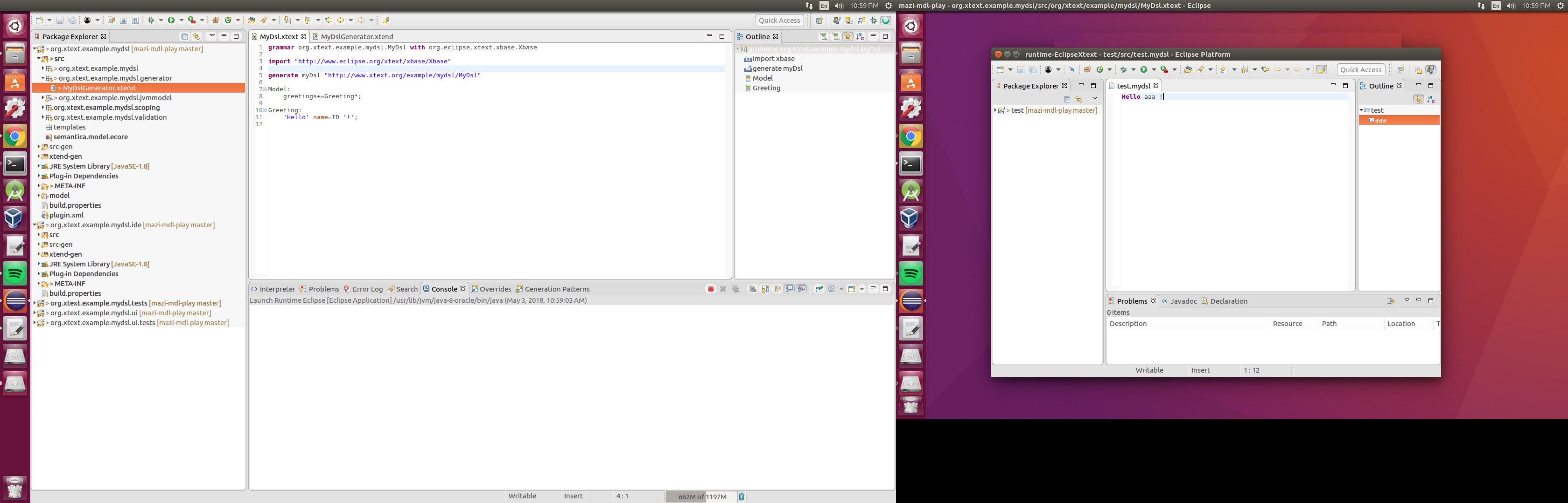

In the first screenshot (with terminals no Xbase )
index.php/fa/32747/0/
you can clearly see that content assist works after the work hello and suggests the word 'name' as a possible option. Same after the word name it suggests the symbol "!"

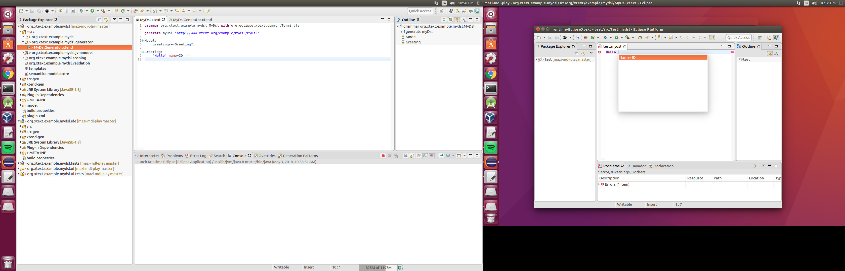

After i introduce Xbase content assist stops working for both name and the "1".
index.php/fa/32748/0/
index.php/fa/32749/0/
Console is clean from any errors and i cant find any other errors anywhere.
Any ideas about this specific problem?

MyDslProposalProvider now inherits from XbaseProposalProvider and not TerminalsProposalProvider which behaves diffently.
e.g. if you move stuff like org.eclipse.xtext.common.ui.contentassist.TerminalsProposalProvider.complete_ID(EObject, RuleCall, ContentAssistContext, ICompletionProposalAcceptor)
back to your proposal provider it will work again.
alternatively simply customize the completeX_y methods e.g. completeGreeting_Name
