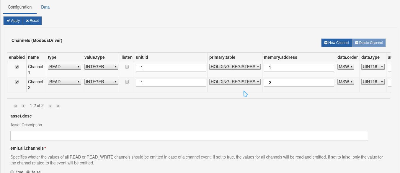

Hi guys, I downloaded the version of kura 3.2.0; I noticed that in the configuration of the asset there are new settings; I tried to create use cases to use the "listen" attribute and set the "emit.all.channel" parameter, but I could not see any changes to the data. My tests were: Timer-> Asset-> Publisher but I do not see data changes.
Could you explain the use of the parameters and when to use them for example in a use case with the wire components?

Hi Stefano,
thank you for downloading and testing the new release!
We introduced some new features in to the Asset model (take a look here [1]).
The listen option can be used to attach listeners/callback to a specific channel, supporting unsolicited inputs. Of course, the driver has to support this, so please check that this is true for your driver (the modbus driver does not support listeners!)
The emit.all.channels is a new option that can be used along with the listen one. When a listener is activated (i.e. a new value is available on that channel), the asset will read all the channels. So, if you enable the listener for a channel that represents a data valid, the asset will read all the channels listed in to the asset.
