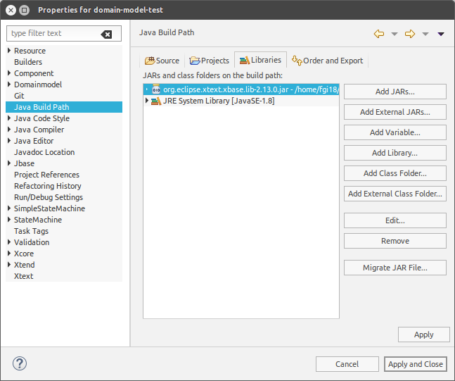

I did it the "old-fashioned" way (simple Java project, no maven/gradle) by downloading the jar from Maven and adding the jar in my classpath (Configure Build Path > Librairies > Add Jars/external jars).
index.php/fa/32586/0/
Re: Integration with Xbase - Domain model example [message #1785282 is a reply to message #1785276] Thu, 12 April 2018 00:38 Go to previous messageGo to next message
org.eclipse.xbase.lib has additional dependencies (e.g. Guava) that are missing here. Use Add Library on this page, Xtext ships a library container for convenience.
