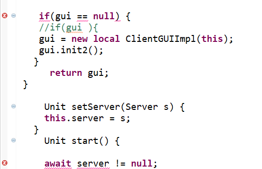

I have written the grammar for If else statement and await statement. But still, during runtime, the editor shows error. I have also found about the dangling problem in if else statement but I have corrected it accordingly, could you please suggest where am I doing wrong.

Runtime Error in Ifelse Statement:
Multiple markers at this line
- missing ')' at '=='
- mismatched input ')' expecting ';'
- no viable alternative at input '('
Runtime Error in Await Statement:
- no viable alternative at input '!='
- no viable alternative at input 'server'
Find the attached file.

is in your grammar else is required / you have multiple ifs.
other tipps:
adapt the workflow to generate a debuggrammar (parserGenerator={debugGrammar=true}) // or something like that
and use antlrworks to analysze
