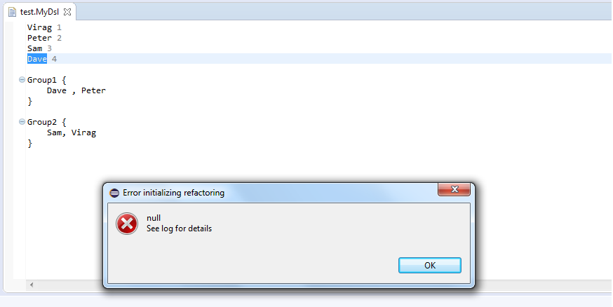

When I try to rename element, I get NPE.
I have mentioned sample grammar.
I am using XText 2.13
Workflow {
	component = XtextGenerator {
		configuration = {
			project = StandardProjectConfig {
				baseName = "org.xtext.example.mydsl"
				rootPath = rootPath
				runtimeTest = {
					enabled = true
				eclipsePlugin = {
					enabled = true
				eclipsePluginTest = {
					enabled = true
				createEclipseMetaData = true
			code = {
				encoding = "windows-1252"
				lineDelimiter = "\r\n"
				fileHeader = "/*\n * generated by Xtext \${version}\n */"
		language = StandardLanguage {
			name = "org.xtext.example.mydsl.MyDsl"
			fileExtensions = "mydsl"
			serializer = {
				generateStub = false
			validator = {
				// composedCheck = "org.eclipse.xtext.validation.NamesAreUniqueValidator"
			renameRefactoring = {
        		useChangeSerializer = true
Grammar:
grammar org.xtext.example.mydsl.MyDsl with org.eclipse.xtext.common.Terminals
generate myDsl "http://www.xtext.org/example/mydsl/MyDsl"
Model:
	students+=Student*
	studentGroups+= Group*;
Student:
	name=ID seatNumber=INT
Group:
	name=ID '{' members+=[Student|ID] (',' members+=[Student|ID])* '}'
Virag 1
Peter 2
Sam 3
Dave 4
Group1 {
	Dave , Peter
Group2 {
	Sam, Virag
Log:
1    [main] ERROR org.eclipse.xtext.ui.refactoring.ui.DefaultRenameElementHandler  - Error initializing refactoring
	at org.eclipse.xtext.ui.refactoring.ui.DefaultRenameElementHandler.isRefactoringEnabled(DefaultRenameElementHandler.java:135)
	at org.eclipse.xtext.ui.refactoring.ui.DefaultRenameElementHandler$1.exec(DefaultRenameElementHandler.java:83)
	at org.eclipse.xtext.ui.refactoring.ui.DefaultRenameElementHandler$1.exec(DefaultRenameElementHandler.java:1)
	at org.eclipse.xtext.resource.OutdatedStateManager.exec(OutdatedStateManager.java:91)
	at org.eclipse.xtext.ui.editor.model.XtextDocument$XtextDocumentLocker.internalReadOnly(XtextDocument.java:520)
	at org.eclipse.xtext.ui.editor.model.XtextDocument$XtextDocumentLocker.priorityReadOnly(XtextDocument.java:485)
	at org.eclipse.xtext.ui.editor.model.XtextDocument.priorityReadOnly(XtextDocument.java:142)
	at org.eclipse.xtext.ui.refactoring.ui.DefaultRenameElementHandler.execute(DefaultRenameElementHandler.java:74)
	at org.eclipse.ui.internal.handlers.HandlerProxy.execute(HandlerProxy.java:291)
	at org.eclipse.ui.internal.handlers.E4HandlerProxy.execute(E4HandlerProxy.java:92)
	at org.eclipse.e4.core.internal.di.MethodRequestor.execute(MethodRequestor.java:55)
	at org.eclipse.e4.core.internal.di.InjectorImpl.invokeUsingClass(InjectorImpl.java:305)
	at org.eclipse.e4.core.internal.di.InjectorImpl.invoke(InjectorImpl.java:239)
	at org.eclipse.e4.core.contexts.ContextInjectionFactory.invoke(ContextInjectionFactory.java:132)
	at org.eclipse.e4.core.commands.internal.HandlerServiceHandler.execute(HandlerServiceHandler.java:152)
	at org.eclipse.core.commands.Command.executeWithChecks(Command.java:494)
	at org.eclipse.core.commands.ParameterizedCommand.executeWithChecks(ParameterizedCommand.java:487)
	at org.eclipse.e4.core.commands.internal.HandlerServiceImpl.executeHandler(HandlerServiceImpl.java:210)
	at org.eclipse.e4.ui.workbench.renderers.swt.HandledContributionItem.executeItem(HandledContributionItem.java:431)
	at org.eclipse.e4.ui.workbench.renderers.swt.AbstractContributionItem.handleWidgetSelection(AbstractContributionItem.java:446)
	at org.eclipse.e4.ui.workbench.renderers.swt.AbstractContributionItem.lambda$2(AbstractContributionItem.java:472)
	at org.eclipse.swt.widgets.EventTable.sendEvent(EventTable.java:86)
	at org.eclipse.swt.widgets.Display.sendEvent(Display.java:4428)
	at org.eclipse.swt.widgets.Widget.sendEvent(Widget.java:1079)
	at org.eclipse.swt.widgets.Display.runDeferredEvents(Display.java:4238)
	at org.eclipse.swt.widgets.Display.readAndDispatch(Display.java:3817)
	at org.eclipse.e4.ui.internal.workbench.swt.PartRenderingEngine$5.run(PartRenderingEngine.java:1150)
	at org.eclipse.e4.ui.internal.workbench.swt.PartRenderingEngine.run(PartRenderingEngine.java:1039)
	at org.eclipse.e4.ui.internal.workbench.E4Workbench.createAndRunUI(E4Workbench.java:153)
	at org.eclipse.ui.internal.Workbench.lambda$3(Workbench.java:680)
	at org.eclipse.ui.internal.Workbench.createAndRunWorkbench(Workbench.java:594)
	at org.eclipse.ui.internal.ide.application.IDEApplication.start(IDEApplication.java:151)
	at org.eclipse.equinox.launcher.Main.invokeFramework(Main.java:653)
	at org.eclipse.equinox.launcher.Main.basicRun(Main.java:590)
	at org.eclipse.equinox.launcher.Main.run(Main.java:1499)
	at org.eclipse.equinox.launcher.Main.main(Main.java:1472)
Need help.
Thanks in advance.

Re: Rename element gives NPE [message #1784163 is a reply to message #1784162] Fri, 23 March 2018 02:52 Go to previous messageGo to next message
Please file this as bug to https://github.com/eclipse/xtext-eclipse/issues
Re: Rename element gives NPE [message #1784174 is a reply to message #1784163] Fri, 23 March 2018 04:44 Go to previous messageGo to next message
i cannot reproduce this in the latest xtext 2.14 nightly.
can you please give it a try
Re: Rename element gives NPE [message #1784187 is a reply to message #1784174] Fri, 23 March 2018 06:18 Go to previous messageGo to next message
Hi Mr. Christian DietrichFriend.
I have used Xtext 2.13.
I will try with 2.14 nightly build as well.
Could you please help me with the path for the same?
Thanks and regards,
Virag Purnam
Re: Rename element gives NPE [message #1784188 is a reply to message #1784187] Fri, 23 March 2018 06:21 Go to previous messageGo to next message
hi you can install xtext 2.14 nightly into your eclipse using this p2 repo: http://download.eclipse.org/modeling/tmf/xtext/updates/composite/latest/
Re: Rename element gives NPE [message #1784343 is a reply to message #1784188] Tue, 27 March 2018 03:00 Go to previous message
Hi, Thanks for the link.
Sorry, I was working on other module.
I will check with this and update here.
