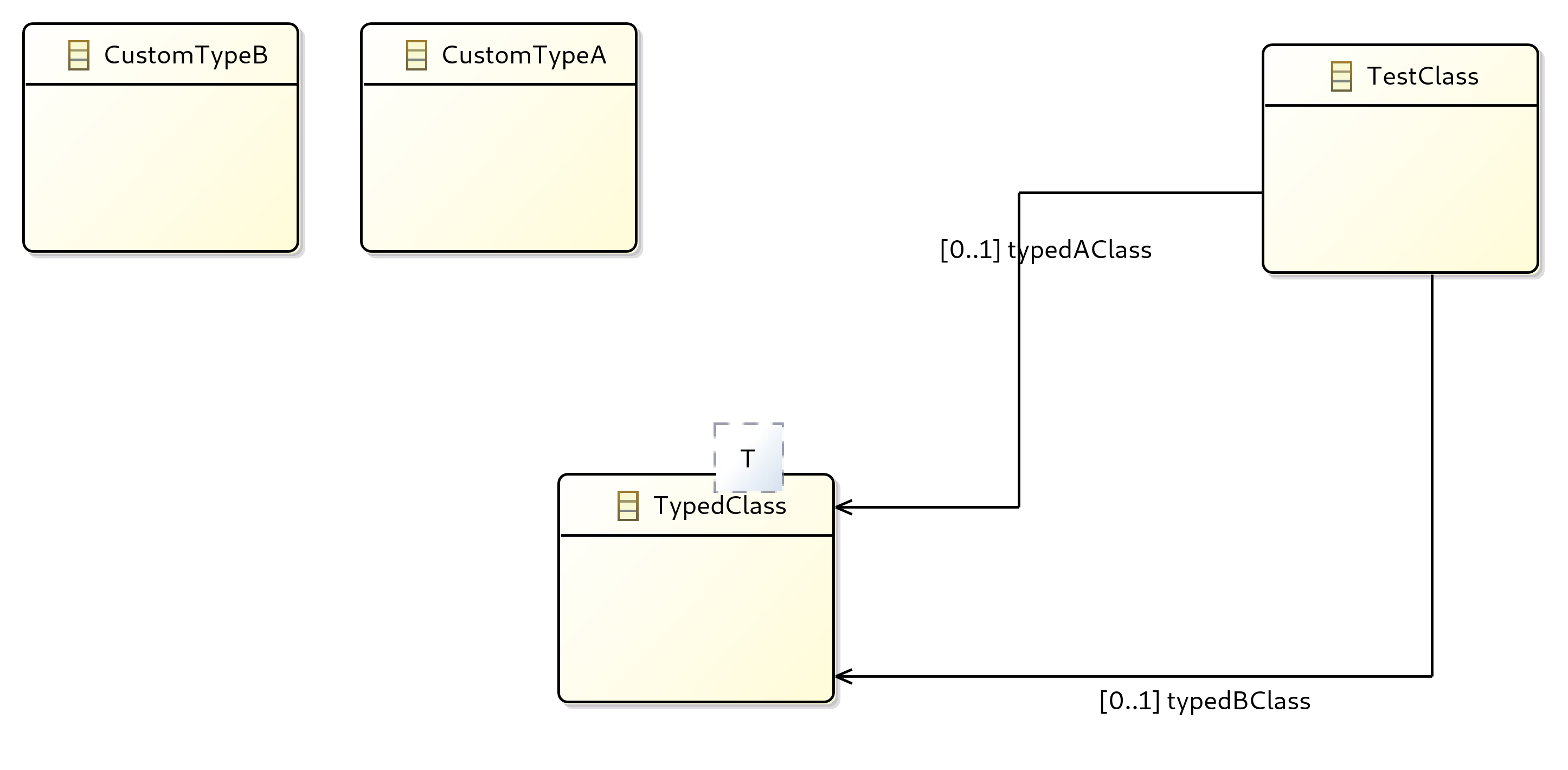

I have a simple model with a generic class.
I want to create an xtext grammar which can instantiate the class with a type parameter.
TestClass returns TestClass:
        {TestClass}
        'TestClass'
                ('typedAClass' typedAClass=[TypedClass<CustomTypeA>])?
                ('typedBClass' typedBClass=[TypedClass<CustomTypeB>])?
TypedClass<T> returns TypedClass<T>:
        {TypedClass<T>}
        'TypedClass'
Is this possible with xtext? I havent been able to find an example using generic objects.
Thank you.
  • Attachment: model.png
    (Size: 95.96KB, Downloaded 86 times)

Can you please give more context
I would have expected something like (pseudo code)
GT: ref=Type (‚<‚ params+=Gt (‚,' params +=GT)*'<‚)?
Re: instantiate object with type parameter [message #1783879 is a reply to message #1783878] Mon, 19 March 2018 15:23 Go to previous messageGo to next message
And no xtext has no support for Emf generics if that is what you are looking for
[Updated on: Mon, 19 March 2018 15:24] by Moderator

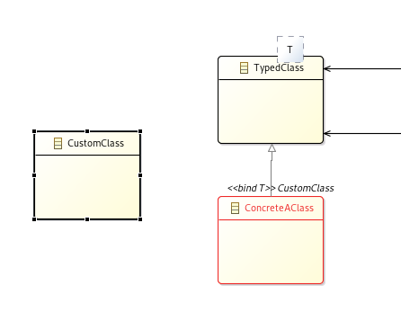

I wonder if there is another way to to get emf generics to work.
Will binding the type parameter in concrete classes work?
	{TestClass}
	'TestClass'
		('typedAClass' typedAClass=[ConcreteAClass])?
		('typedBClass' typedBClass=[ConcreteAClass])?
ConcreteAClass returns ConcreteAClass:
	{ConcreteAClass}
	'ConcreteAClass'
  • Attachment: model2.png
    (Size: 12.84KB, Downloaded 71 times)
