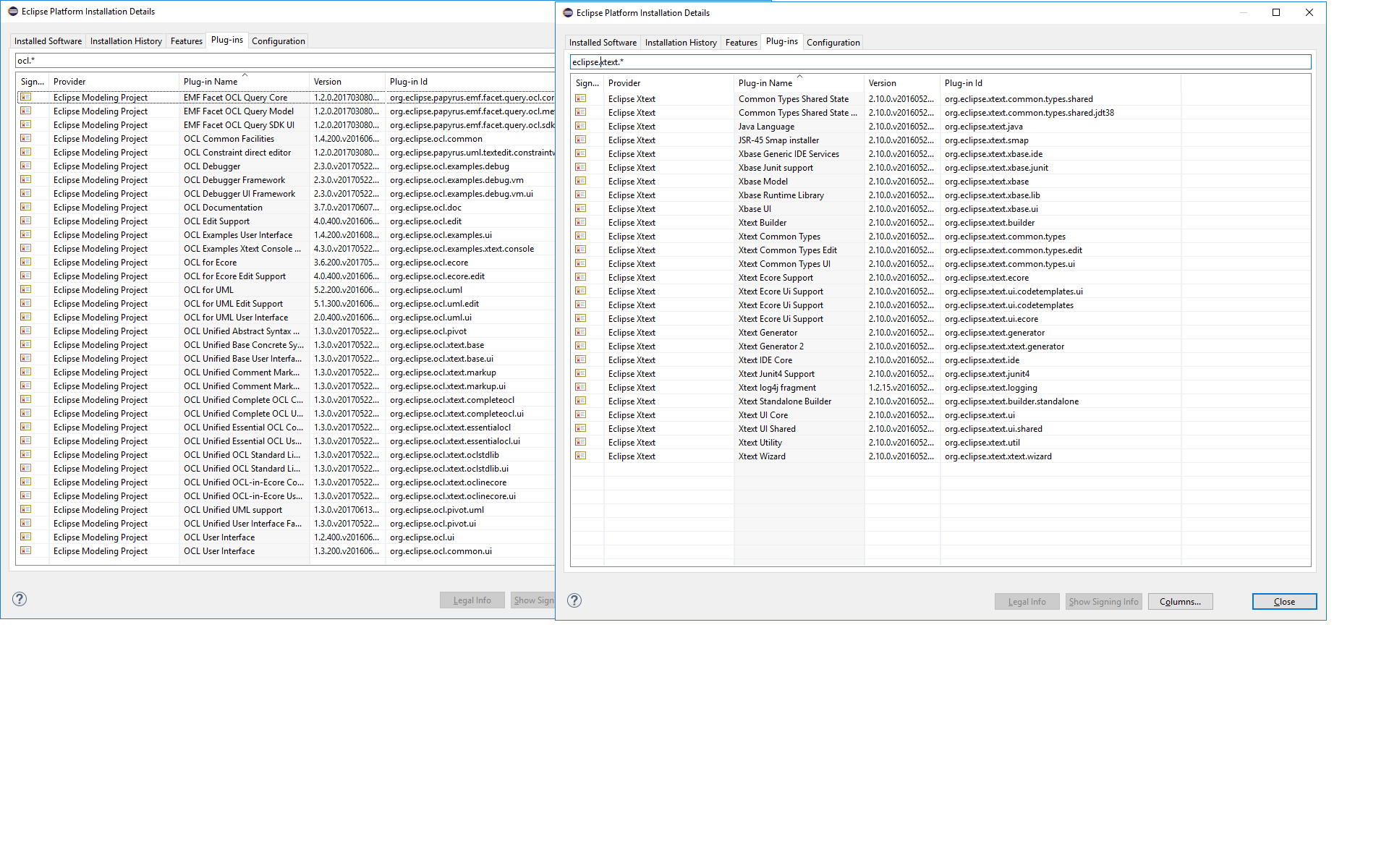

To give you an idea about the versions we use, I attach our target platform definition and the manifest of the main project.
Chris

I don't see anything particularly concerning in your versions, except that by using Neon you miss 18 months of developments. (You also need to choose between the Neon and Neon++ releases to workaround a breaking Xtext API change.)
Using https://wiki.eclipse.org/OCL/New_and_Noteworthy/Oxygen to refresh my memory, the following might be very relevant

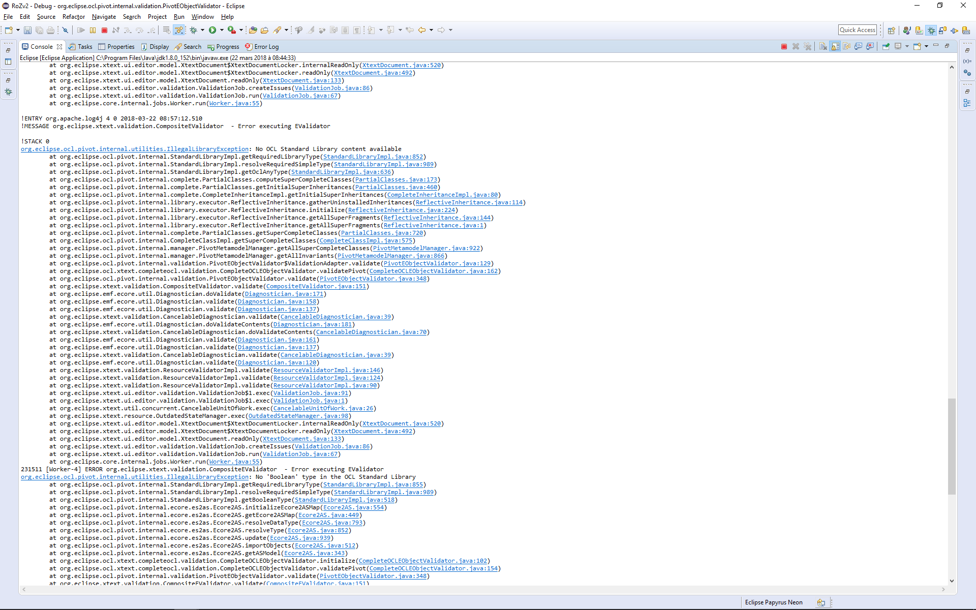

Hello Ed, Christian
I think that the initial hunch of Christina that it is a race condition was right.
I did some tests. I created a xtext DSL (the hello world example), and started a new workspace in which I opened three model files in three different editors.
Then I put a breakpoint in CompleteOCLEObjectValidator.initialize and restarted the workspace. The initialization of each of three editors triggered OCL validation in different working threads.
All tried to initialize simultaneously the same CompleteOCLEObjectValidator as shown in this screenshot
index.php/fa/32401/0/
Depending on the interleaving of the initialization, some times it works, sometimes I got similar kind of exceptions (no ocl stdlib) as Christian has, as shown here
index.php/fa/32402/0/
the exception stack is not exactly the same as Christians, but I think that the CompleteOCLEObjectValidator is not really designed to be thread-safe, so it can happen in other situations.

Hi Ed,
The problem is not really that xtext editors are introducing some hidden sharing, the bottom line is that all are using the same singleton EMF's EValidator.Registry.INSTANCE for performing validation.
So xtext registers the CompleteOCLEObjectValidator in the validation chain of EValidator.Registry.INSTANCE, and from then on it will be implicitly shared by any application (not only xtext editors) that uses the standard org.eclipse.emf.ecore.util.Diagnostician
Because initialization of CompleteOCLEObjectValidator is lazy, it can really happen in any thread (depending on how it is triggered : from a menu, from a builder, ..... ) and sometimes it can happen concurrently in several threads.
The scenario of having three opened files (you can see them at the right of the first screenshot test.mydsl test2.mydsl test3.mydsl) was just a way to systematically reproduce the problem. The files had nothing in particular.
The steps to reproduce the scenario are the following :

7) the first thing each editor will do on reopening is try to perform a validation in a working thread, and you will get into the situation of the first screenshot
I agree with you that EMF itself is not thread safe, but validation needs just read-only access to the model so it should work .. the problem is all the side-effects that are not really read-only (loading of resources, CS2AS , calculation of the complete OCL model, ...)
I know you really did a great effort and wonderful job to make OCL work in isolated resource sets and as transparently as possible... but there are so many singletons in EMF that multi-thread sharing is almost inevitable ...
