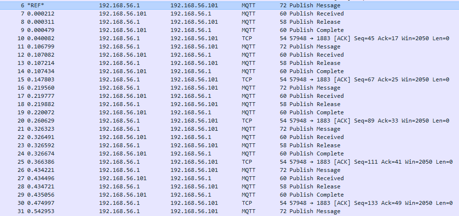

in my project I need to publish messages with high frequency. The publish result must be synchronous, to retry the publish later in case of issues.
For this reason I am using the parameters QoS=2 and Reliable=true (message queue size equal to 1).
With this configuration Paho sends messages with a frequency of 10 messages/second (see attached wiresharkSnapshot.png). The issue seems to be related to the "timeout" const in MQTTClient_yield(), called by MQTTClient_publish function.
I tried to reduce the value to 10ms and the delay disappear, apparently without introducing drawbacks.

from what I understood from the support, this timeout regulates how long the system should wait for new messages before sending them. The purpose is to try to create a package with multiple messages to maximize the throughput.
Unfortunately for my requirement I need to send the messages one by one. So the only solution is to reduce the timeout from 100 ms to 10 ms.
I also opened a Github request and they will put this value as configurable: https://github.com/eclipse/paho.mqtt.c/issues/452
