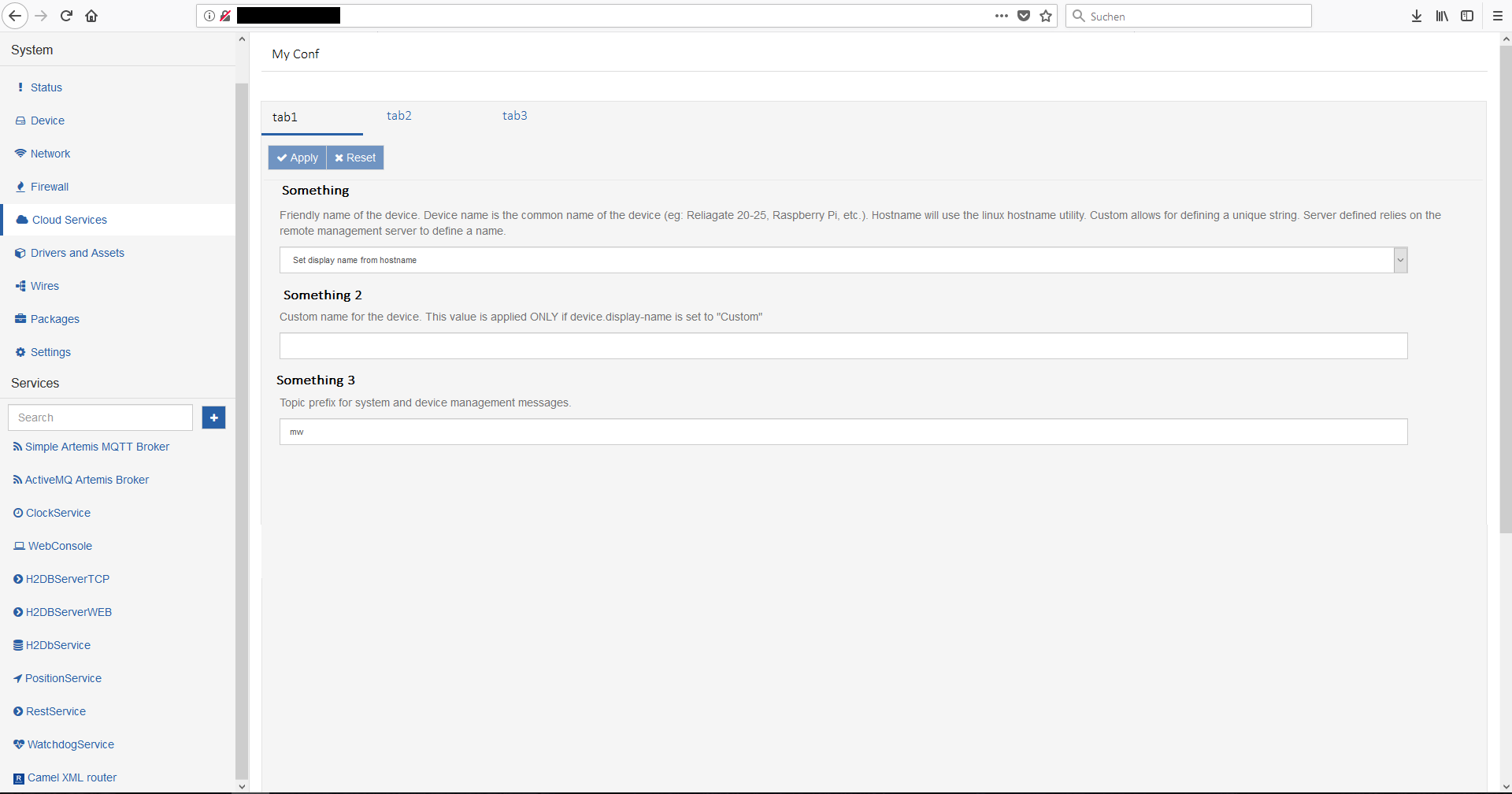

Hey guys,
i need to write a conf bundle with tabs. How do i realize that ?
Please look into my attachment.
Same as in "Cloud Services" where the tabs are CloudService / Data Service / MqttData Transport.
Thanks in advance.
Greetings Amal

Hi, should that be fixed?
Or dynamically added to the UI?
For the first I would suggest changing the web2 bundle adding the sections you need.
Matteo

Hi Matteo,
The first 3 tabs in my bundle should be fix
And there should be the the option on button click to add dynamically more.
change the web?? Is there any example to adding tabs to a bundle.
I just know AD for adding field/options/combo etc...
Thanks.
Greetings Amal

I believe you should start working on this bundle: https://github.com/eclipse/kura/tree/develop/kura/org.eclipse.kura.web2
Matteo
