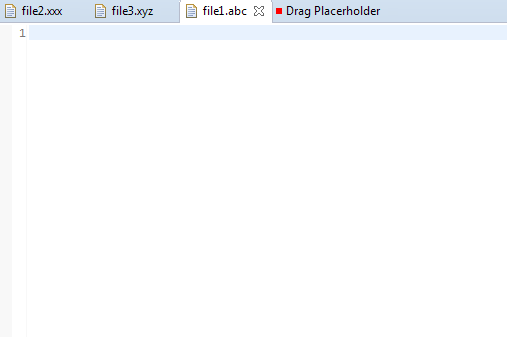

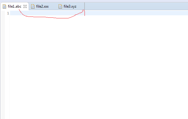

I made an IPartListener so when I change between different file types I can change perspective automatically. But when I drag an editor tab to a new location, it iterates over the other tabs it crossed. Now I think because of this, the editors getting activated and eclipse wants to change perspectives too fast. And I get a new tab added named: Drag Placerholder which is an ErrorViewPart. My code:

I attached some pics, if I drag file1.abc after file3.xyz and the files between would use other perspective, I end up with a 4th tab and a NullPointerException
index.php/fa/31787/0/
index.php/fa/31788/0/
What causes it and what should I do?
