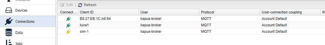

I use the kapua as cloudservice and connect kura. Then install the org.eclipse.kura.demo.heater to the kura. Erverything is OK, the kura log show the publish message is confirmed .But in the kapua console i cannot see the publish data .I am sure the kapua can receive data (simulator-kura have test).
What's the problem?Where is the publish data?

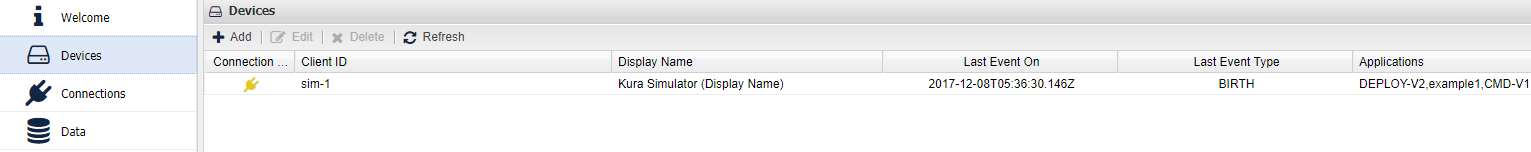

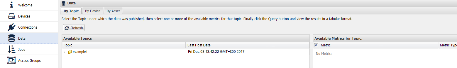

I can see my device in the Connections tab,but i cannot see it in the Devices tab and have not data in the Data tab.(the disconnect device is simulator-kura and example1 topic is simulator-kura generate)
