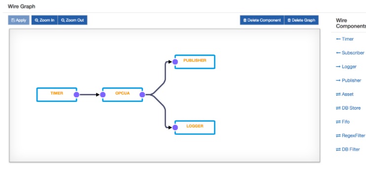

We are trying to create examples with OPC/UA,
but we are limited by the fact that they apparently do not exist, as per
Modbus, two bundles to install in eclipse:
org.eclipse.kura.driver.modbus.localization
org.eclipse.kura.driver.modbus.provider
For opc / ua, as recommended by the documentation, we used an opc / ua server simulator installed as a bundle, which we used in the following graph:
that worked properly.
Does not exist for OPC/UA a pair of org.eclipse.kura.driver bundles ...... as for Modbus?
thank you
(N.B. we are always working in windows....)
  • Attachment: opcua.jpg
    (Size: 30.81KB, Downloaded 218 times)
Re: OPC/UA & Modbus in Kura [message #1777362 is a reply to message #1777246] Tue, 28 November 2017 15:41 Go to previous message
OPC-UA is available as a driver and can be used both with Wires or, by a specific Java application that interfaces with the Driver, like done by the demo.modbus example application.
Currently, we don't have a standalone example that uses the OPC-UA driver but all the contributions are more than welcome :-)
