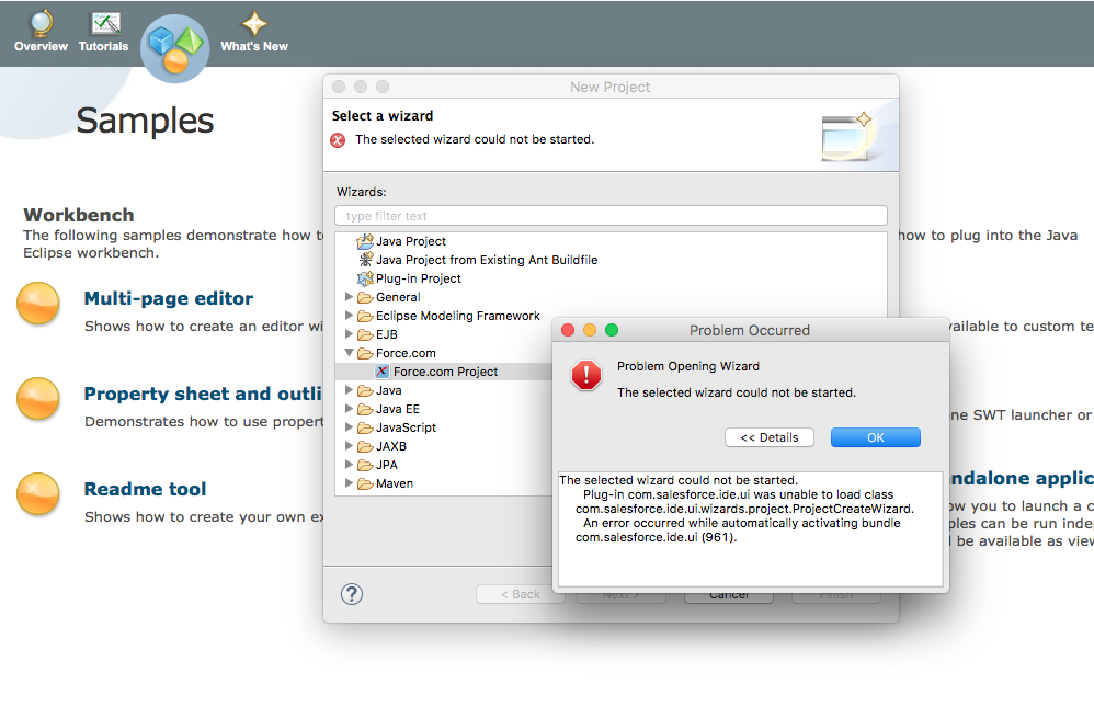

After installing Force.com plug-in, I immediately receive an error when trying to create a project:
The selected wizard could not be started.
Plug-in com.salesforce.ide.ui was unable to load class com.salesforce.ide.ui.wizards.project.ProjectCreateWizard.
An error occurred while automatically activating bundle com.salesforce.ide.ui (961).
If anyone was able to help me resolve this i'd be extremely appreciative. Thank you!
Re: Force.com IDE Plug-in receives error when creating new Project in Eclipse [message #1775698 is a reply to message #1775181] Fri, 03 November 2017 11:48 Go to previous messageGo to next message
Hi, Any luck getting to the bottom of this? I too have same issue. Tried installing Mars 2 for Java & Java EE. Still no luck. I'm running Mac OS 10.12.6. Thanks.
Re: Force.com IDE Plug-in receives error when creating new Project in Eclipse [message #1775716 is a reply to message #1775698] Fri, 03 November 2017 16:32 Go to previous messageGo to next message
I was able to get up and running. Downloaded the JDK 8 Installation on Oracle site (https://docs.oracle.com/javase/8/docs/technotes/guides/install/mac_jdk.html) . Set it as default (https://stackoverflow.com/questions/21964709/how-to-set-or-change-the-default-java-jdk-version-on-os-x). Then downloaded latest version of Eclipse - Oxygen (October 2017).....all seems to be working. Hopefully that helps!
