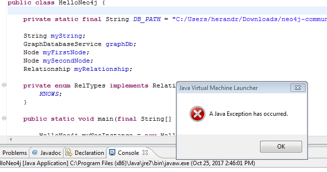

index.php/fa/31124/0/I got a new laptop Windows 7 64bit and I want to code in java. I installed Eclipse helios, but I´m not sure about my java configuration
I got the error :
In Eclipse I Properties->Java Build Path I have jre7
C:\Program Files (x86)\Java\jre7\bin
Which I guess is JRE version 7. But in my command line I have;
index.php/fa/31125/0/

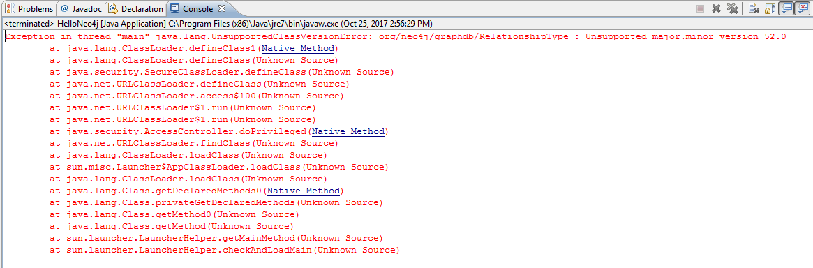

If I run my app I got this error:
index.php/fa/31126/0/
I would appreciate any suggestion/correction

Any particular reasons you use an Eclipse version from 7 years ago?
At that time not even Java 7 existed (not to mention Java 9), so working with Java 7 on Helios doesn't sound like a very good combination of versions.
In addition you seem to use a library that was compiled for Java 8 and thus cannot be run on Java 7.
