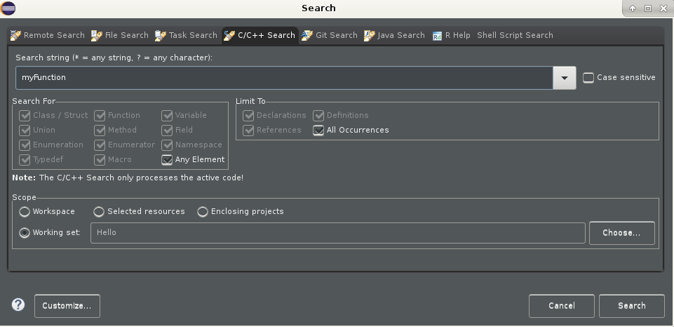

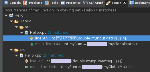

Works for me.
index.php/fa/30966/0/
index.php/fa/30967/0/
Note the caveat that only active code is searched.
Maybe your working set isn't as inclusive as you think.
Try searching with a File Search instead for comparison.
Perhaps you could post a small project with a failed search so we can try it too.
