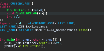

Works for me.
index.php/fa/30717/0/
DId you define CUSTOMCLASS?
If not then CLASS_METHOD isn't really a member.
Here, I've substituted XXX and pXXX.
Note that (*pXXX)->CLASS_METHOD() can't be resolved.
index.php/fa/30718/0/
Neither CDT nor the compiler will be able to resolve it.
If your code compiles and runs then it is different than what you've posted.
If you continue to experience this problem then post a small complete program that illustrates it.

Unfortunately I cant post much actual code because the system is on a closed network, but that example you have made above is sufficient. Just as a test I went ahead and implemented it in my copy of eclipse and it does fail for me in the same places. Neither the val in (*LIST_NAMEinstance.begin())->val; nor the CLASS_METHOD in (*NAME)->CLASS_METHOD(); resolve in my eclipse for some reason.
If I add
CUSTOMCLASS *test;
test->CLASS_METHOD();
CLASS_METHOD will resolve for the local variable, so the class is being recognized but for some reason once I start working with the iterators everything seems to stop working for some reason.
