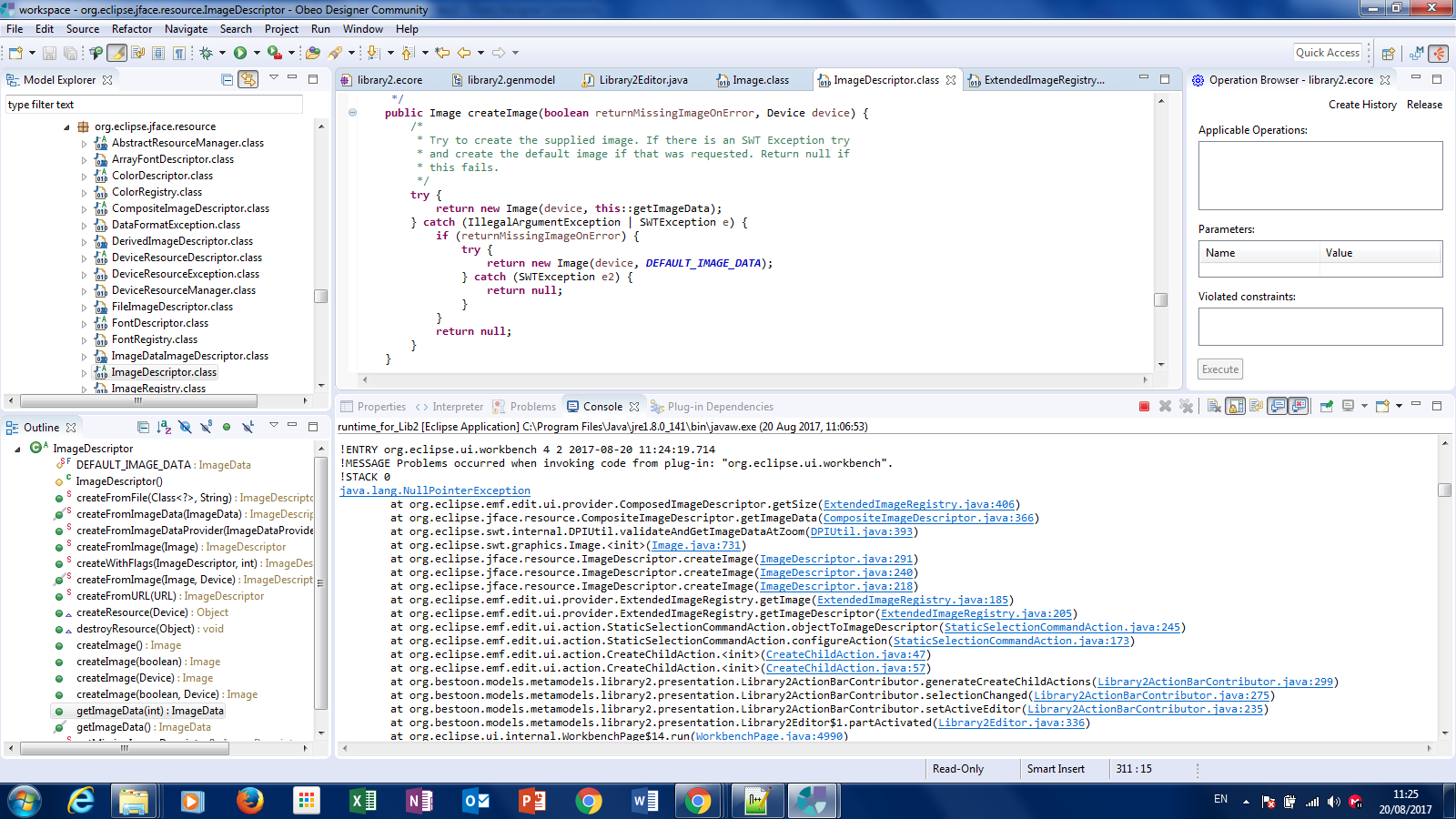

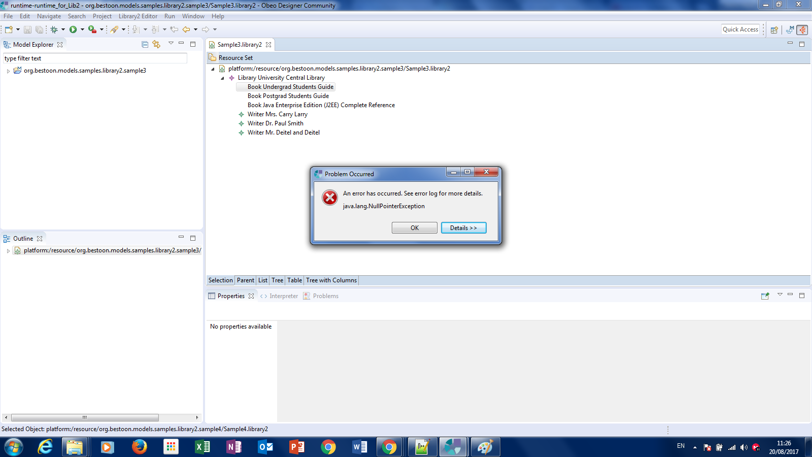

After EDapt migrated my model instance, I got a Null Pointer Exception (generated by org.eclipse.jface plugin when trying to render an icon image) as shown in the attached image files. I tried to debug and find the source of the problem, but I didn't get why the icon is rendered for some of the child nodes (the newly created nodes) but not for the old existing child nodes!

Concerning the NPE that I'm getting, it is only when I use EDapt to migrate my model instances. I have many times created a new instance model without ever getting such NPE. I have also re-generated the Edit plugin. So, I think it has something to do with EDapt and my guess is that it is because EDapt has changed the nsURI of the plugin and this might caused the icon image of the old child nodes to point to an incorrect resource location?!

I had a look at your projects. The BookItemProvider has no getImage method. Thus it returns null causing the NPE.
In the genmodel go to Book -> in properties view -> Edit -> Image -> change from false to true -> regenerate edit code
