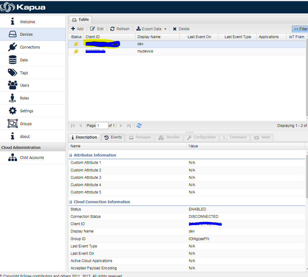

Please help me.
I was able to publish & subscriber the message on Kura Wires with ActiveMQ using Kapua. I am not able to connect the devices in kapua.
Please find the screen shot.
Re: Kura with Kapua [message #1769674 is a reply to message #1769635] Wed, 02 August 2017 10:45 Go to previous messageGo to next message
I believe this is more a Kapua-related question.
Anyway, did you check the permissions of the credentials you used to connect to the platform?
Maybe there is something that needs to be solved there.
Matteo
Re: Kura with Kapua [message #1770365 is a reply to message #1769674] Thu, 10 August 2017 08:07 Go to previous message
@kiran kumar
What credentials do you use for Kapua login? Is it default, kapua - sys and kapua-password?
In that case you need to add new account and under that account to add user and to add permissions for that user. After that, put that user credentials and account name in Kura cloud service setup tab.
