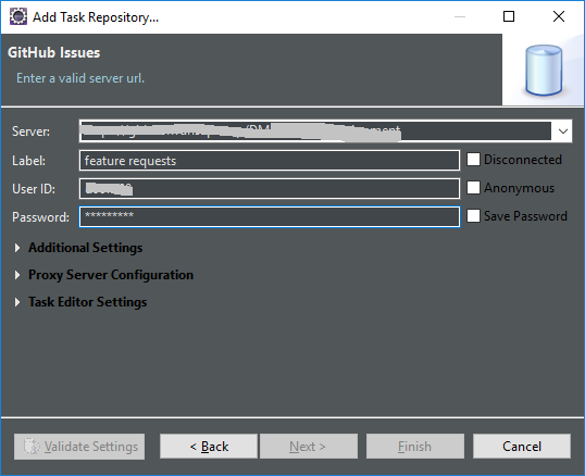

i have a GitHub repository that i want to use to share tasks among our team members. When adding the task repository, i am not able to click the "Finish" button, as it is disabled.
