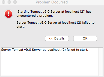

I'm using the Eclipse JEE IDE (Version: Neon.3 Release (4.6.3)) on my Mac 10.11.3.
I created a first Java dynamic web project, experimented a lot with it, using the associated Tomcat server freely. At some point Eclipse froze (probably because of some mistake I made) and even restarting Eclipse wouldn't allow me to de-freeze the project, so I had no choice but to delete the project (keeping a backup of the code) and recreate it from scratch.
The problem is, there seems to be some remains of my old project still using the server,
(even though I physically erased the old project files on my disk)
because when I try to run my new project I get the following error message :
index.php/fa/30139/0/
How can I find which "process" is still using the server ?
Any help appreciated.

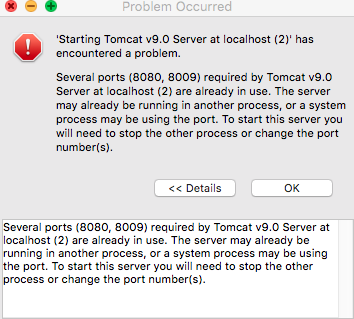

Re: Who's using my server behind my back ? [message #1769099 is a reply to message #1769075] Wed, 26 July 2017 10:03 Go to previous messageGo to next message
One simple solution would be to reboot your machine, which will kill the process that's using the ports.
There are ways to determine what process is holding a particular port, and kill it. For example: https://stackoverflow.com/q/3855127/639520
Re: Who's using my server behind my back ? [message #1769117 is a reply to message #1769099] Wed, 26 July 2017 13:00 Go to previous message
Eric Rizzo wrote on Wed, 26 July 2017 14:03
I did as advised in the Stackexchange link :
$ lsof -i tcp:8080
COMMAND   PID         USER   FD   TYPE             DEVICE SIZE/OFF NODE NAME
java    12949 roparzhhemon   47u  IPv6 0xac7201556db67eed      0t0  TCP *:http-alt (LISTEN)
$ lsof -i tcp:8009
java    12949 roparzhhemon   52u  IPv6 0xac7201557921b46d      0t0  TCP *:8009 (LISTEN)
$ kill 12949
Now, when I retry I get a different error message :
index.php/fa/30147/0/
