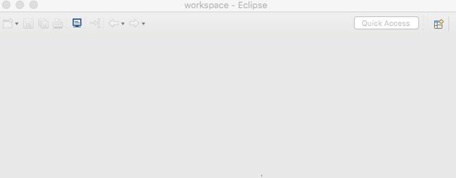

On my Mac 10.11.3 I've installed the Eclipse JEE IDE (Version: Neon.3
Release (4.6.3)).
If I try to open/create a project or file, Eclipse will let me fill the form
to define the project's parameters, but when I click on "Finish" nothing happens
and I am stuck with an empty main window :
index.php/fa/30075/0/
Any help appreciated.

Re: Eclipse opens but won't do anything (main window stays empty) [message #1768723 is a reply to message #1768718] Sat, 22 July 2017 10:24 Go to previous messageGo to next message
You appear to have lost your editor area some how. The title bar and lower status area indicate that you have an editor open, so you appear to have created a project. Have you tried to reset the perspective from the Window->Perspective->Reset Perspective menu item? That should rebuild the perspective and show the editor area.

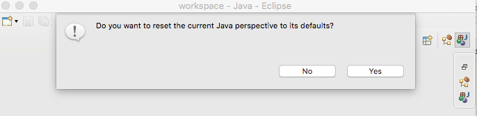

Re: Eclipse opens but won't do anything (main window stays empty) [message #1768724 is a reply to message #1768723] Sat, 22 July 2017 10:51 Go to previous messageGo to next message
David Wegener wrote on Sat, 22 July 2017 14:24
When I do that, I get the following pop-up :
index.php/fa/30078/0/
Clicking on any of Yes or No simply closes the question box and returns to the initial empty window shown in my previous post.

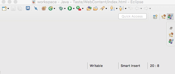

I also tried the "Close all perspectives" menu item, and the only effect it has is to remove some items in the upper part of the window :
index.php/fa/30079/0/

Re: Eclipse opens but won't do anything (main window stays empty) [message #1768725 is a reply to message #1768724] Sat, 22 July 2017 11:12 Go to previous message
Finally, I found that "removing all perpectives" followed by "Open perspective" restores the normal view. Problem solved
