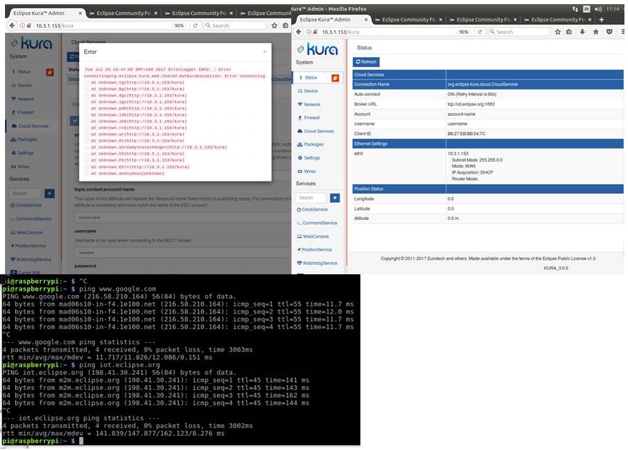

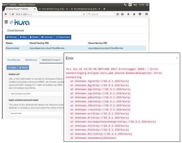

I'm trying to use iot.eclipse.org port 1883 to publish messages to the cloud. I installed the demo heater bundle on my raspberry pi and set the broker-url to mqtt://iot.eclipse.org:1883 and the connect.auto-on-startup* to true.

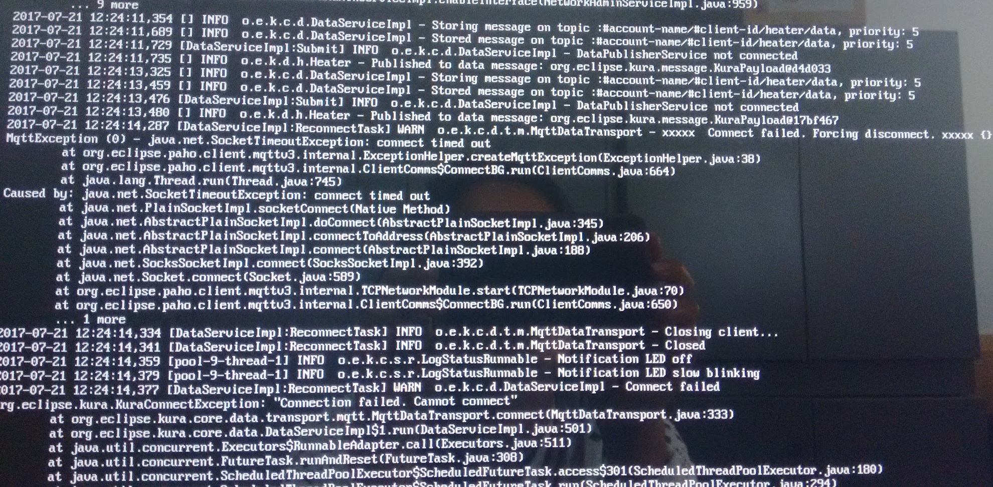

I saw that my status did not change. I have tried the url mqtts://iot.eclipse.org:8883 too but the error is the same. I displayed the Kura log and said that DataPublisherService not connected.
What must I do? Thanks.

Re: MQTT and demo heater [message #1768890 is a reply to message #1768690] Mon, 24 July 2017 11:48 Go to previous messageGo to next message
could you please share the entire configuration you used?
Did you try to connect at a different time? Because it can happen that the connection does not succeed due to the high load of the Eclipse broker.
Matteo

Hi Mateo,
Thanks for your response.
I installed the heater bundle to Kura 3.0.0 in my raspberry pi B (with raspbian) and configured the MQTT client in the MqttDataTransport (broker url) and the DataService (connect.auto-on-startup). I guess I have internet access because I am able to ping to google.com but I don't really know.

Re: MQTT and demo heater [message #1768976 is a reply to message #1768974] Tue, 25 July 2017 06:35 Go to previous messageGo to next message
it seems that the framework is not able to reach Internet.
As you can see from the log, the gateway is not able to sync the clock.
Which is your network configuration?
Matteo

Re: MQTT and demo heater [message #1768998 is a reply to message #1768994] Tue, 25 July 2017 10:05 Go to previous messageGo to next message
Ok, so it seems correctly configured.
Are you in a residential network or a business one? Is it possible that you have a firewall that is blocking the mqtt ports?
Just to do a simple test. If, from the device, you do a
telnet iot.eclipse.org 1883
, what happens?
Re: MQTT and demo heater [message #1769011 is a reply to message #1768998] Tue, 25 July 2017 11:52 Go to previous messageGo to next message
I am in a business network. Yes, probably I have a firewall blocking the mqtt port.
I did the test and got the following response:
Trying 198.41.30.241...
telnet: Unable to connect to remote host: Connection timed out
Thanks for your help.
[Updated on: Tue, 25 July 2017 12:10] by Moderator
Re: MQTT and demo heater [message #1769019 is a reply to message #1769011] Tue, 25 July 2017 13:36 Go to previous message
I believe it is the case, since you are having the same issue with telnet.
