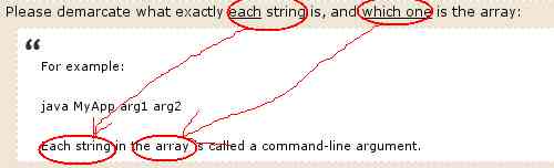

But then, the doubt remains. Could a kind individual please explain the line from http://docs.oracle.com/javase/tutorial/getStarted/application/index.html, that is, Please demarcate what exactly each string is, and which one is the array:
This array is the mechanism through which the runtime system passes information to your application. For example:
java MyApp arg1 arg2
Each string in the array is called a command-line argument.

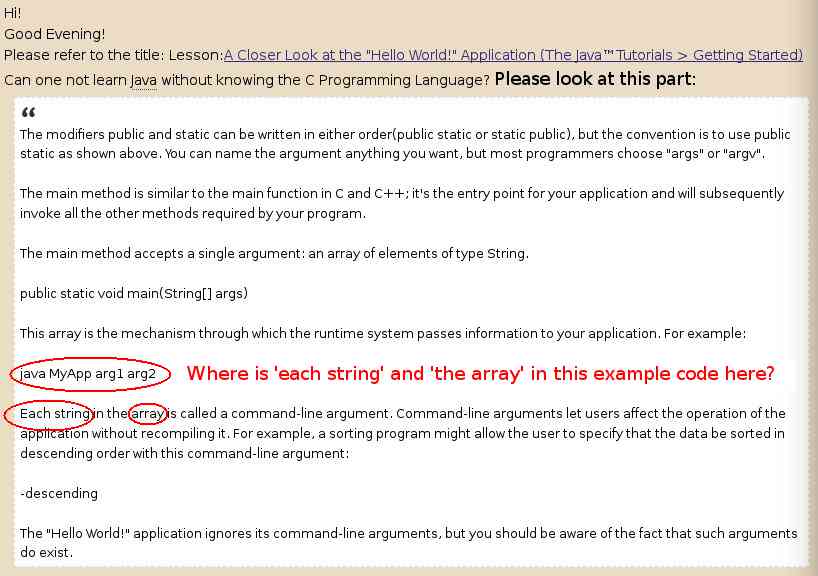

Thank you sir, for replying. I know about arrays and strings. I wanted an idea w.r.t. that page I had linked: http://docs.oracle.com/javase/tutorial/getStarted/application/index.html
Kindly once again peruse the page via the link provided.
I will post the snapshotsindex.php/fa/30011/0/
index.php/fa/30012/0/
and request you to explain w.r.t. those snapshots.

You're right it's not that clear. This is what happens when really smart people try to write tutorials.
A simple explanation is the input to MyApp takes an Array of Strings. The first index of the Array contains arg1, the second index of the array contains arg2. So the call could be MyApp(ArrayofStrings)
Since ArrayofStrings is an array of strings, the input is resolved into arg1 and arg2.
In python
ArrayofStrings = "test", "test2"
The tutorial is also throwing another idea at you, and that is the idea of optional arguments. The main method has optional arguments which simply means you can call main like this
main()
If you want to pass arguments to main, you make an array of strings like above and pass it in like:
main(ArrayofStrings)

But also look at this portion:
The main method accepts a single argument: an array of elements of type String.
public static void main(String[] args)
My question is: If the main method accepts only a single argument, how come it is an array of elements of the type string. There should only be one array of type String, an array having many character elements. So the statement should have been:
Amended Portion of that Note:
The main method accepts a single argument: an array of elementscharacters of typeforming a String.
Don't worry, I got your point! It is possible in C, I know. So, it must also logically be possible in Java!
I was just trying to show how the writer made a mess of a simple point.
I thank you!
