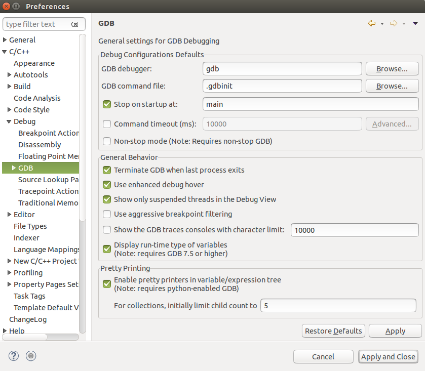

I have the issue that debugging with GDB in eclipse CDT gets extremely slow when large lists/variables/vectors are involved. When I hover over a large variable or have the "Variables" view open it takes sometimes 5-10 minutes to show the values.
In that time I can not continue stepping through the program.
When the variables are shown finally and I step forward I have to wait again more than 5 minutes until it shows the updated variables. I tried everything I found on the internet to speed up, but nothing worked.
Please see my eclipse GDB config below.
I'm running ubuntu 14.04 with Eclipse Oxygen and GDB 7.7.1.

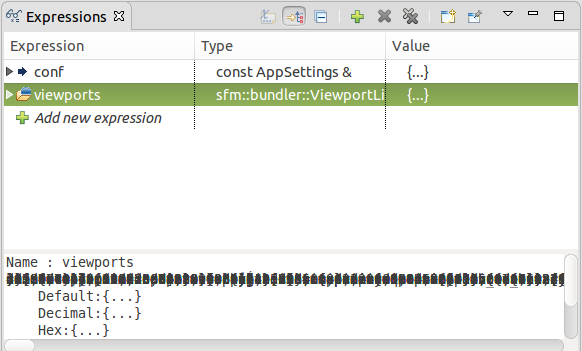

The big variable is called "viewports" which is a vector of class "viewport", with 998 elements with each quite some nested more objects.
I add viewports to the expressions and click only on the expand arrow. It lists only the first 5 elements, everything is fine.
But as soon as I collapse the viewports it selects the variable itself and GDB issues the "data-evaluate-expression --thread 1 --frame 0 viewports", which then takes around 5 minutes. GDB runs with 100% CPU on one core and then returns the result to eclipse which lists ALL contents of "viewports" in the gdb traces.
This results in a weird overlapping display in the expressions tab, see the screenshot below.
I attached the gdb traces as txt-file for you to see where is the problem.
The problematic command is 144.

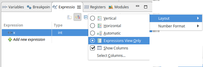

The data-evaluate-expression comes from the details pane in the Experessions view.
Try turning it off, press the down facing triangle --> Layout --> Expressions View Only
index.php/fa/29945/0/

- "Use enhanced debug hover" in the GDB settings is disabled
- "Editor->Hovers->Debugger" is also disabled, as David suggested
There seems to be no project specific setting for hovering.
Any other hover settings I have to change? I also restarted Eclipse already.
