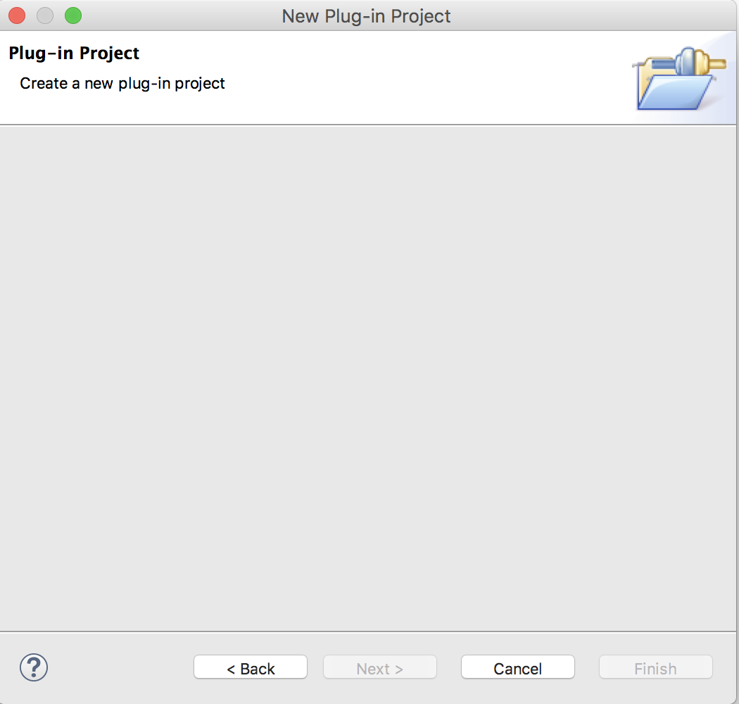

I am trying to create a plug-in project, all I see is a blank space.
Even If I open any plug-in project, I am not able to open manifest.mf file
Is there any way I can use this in Tester version?

Hi Kanchan.
I just installed a fresh version of the Papyrus-RT tester environment and was able to create a Plug-in project without trouble.
Can you post the contents of "Installation Details"? (In macOS go to Eclipse->About Eclipse->Installation Details and post what you have under "Installed Software", showing the full version numbers).

Re: Not able to create Plug-in Project in Papyrus-RT Tester version [message #1767408 is a reply to message #1767407] Wed, 05 July 2017 13:10 Go to previous message
It looks like you are on a pretty old version of Papyrus-RT (0.8.0) on Neon (4.6.2). I would strongly suggest to upgrade to the latest. The latest release is 0.9.0 but we are releasing 1.0 relatively soon (although officially not yet). If you install with Eclipse installer the tester version you will get the nightly which is the pre-release 1.0 on Oxygen (4.7).
In any case, as I mentioned, the problem doesn't seem to be Papyrus-RT, as creating plugin projects works fine in a clean tester installation, so it's possible that one of the other packages that you have installed is somehow conflicting with the PDE.
