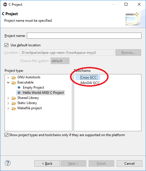

Hi guys,
I'm usually used to program with command line but for this project, I would like to use eclipse.
I'm following the tutorial on esp-idf - get started with eclipse (I can't give the link as it's my first message here)
But at the step : - On the same page, under "Toolchain for Indexer Settings" choose "Cross GCC". Then click Finish.
I have no cross-gcc option. I there a specific module to add to eclipse?
Thanks in advance.
Re: [ESP-IDF] No cross-gcc option [message #1764785 is a reply to message #1764714] Fri, 02 June 2017 05:16 Go to previous messageGo to next message
I assume you are referring to this option in the new project wizard?
index.php/fa/29535/0/

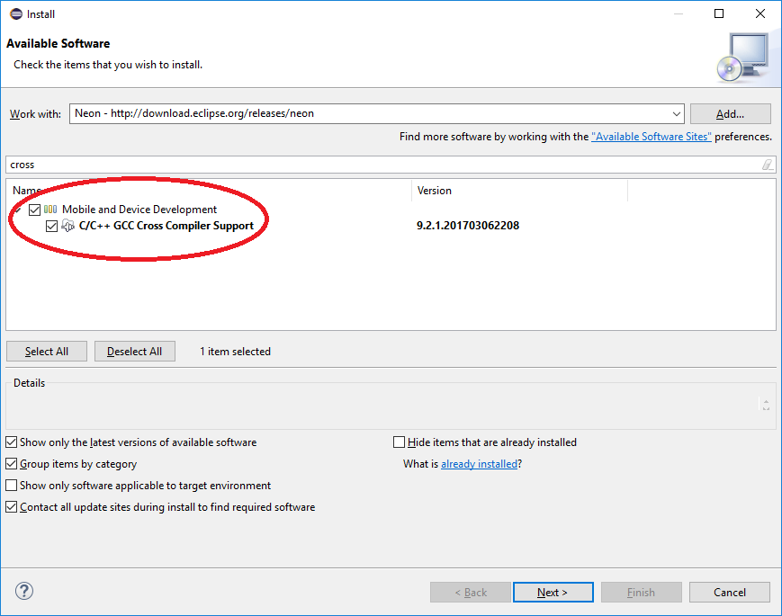

The from the Help menu choose Install New Software, select Neon (or the version of Eclipse you are using -- Neon is the most recently released Eclipse version) and then choose "C/C++ GCC Cross Compiler Support" and finish the wizard:

Thanks a lot, that's exactly what I was looking for ;)
