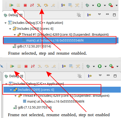

Both Eclipse & MinGW are working except the step into / over (F5/F6) debugger function are not available / active, even though it does stop at the breakpoint that was set. The only option available in is to terminate the Hello World program.
Are you finding the Resume (F8) is enabled, but step is not? Do you have a Frame selected in the Debug view (as opposed to a launch)?
index.php/fa/29559/0/
If that is not the problem, then this is a new one for me. Please help me to reproduce it.
