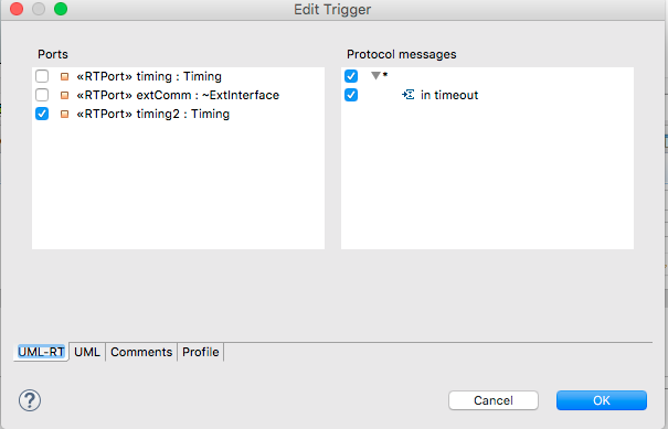

In the previous version of PapyrusRT, I could set * as the message of a trigger, and it worked correctly (i.e., The transition is taken on every message of the related protocol ).
I version 0.9, when I set * for the message, it consumes the incoming message, but the transition is not taken.
The bug easily can be reproduced using a timer and setting the trigger of a specific transition to * which show in the following figure.
index.php/fa/29428/0/

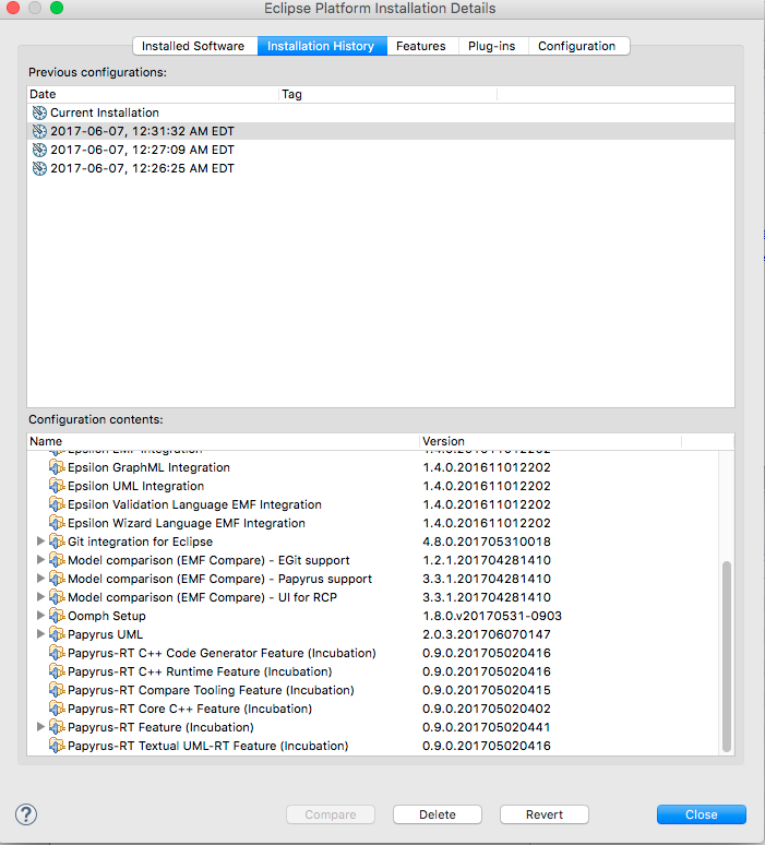

Is this fix available in the test version? I updated my test version but the issue is not resolved, here is my version:
index.php/fa/29575/0/
How can I get this fix on test or user version?
Re: setting * as the message of the trigger does not work properly (v0.9) [message #1765205 is a reply to message #1765148] Wed, 07 June 2017 10:04 Go to previous messageGo to next message
It looks you do not have the latest nightly in your environment. The bundles show version 0.9.0.20170502nnnn. The 20170502 is the date of that build: 2017-May-02, and as my response, where I indicated that the fix was merged is from May 23, then that change is not in your environment.
To confirm, I have just installed a fresh tester environment, ran a test and it generates code correctly for the * event.
If you created the tester environment with "nightly" as the build type, you can run "Help->Perform Setup Tasks...->[Finish]" to ensure that you get the latest updates from the nightly update site (and dependencies).

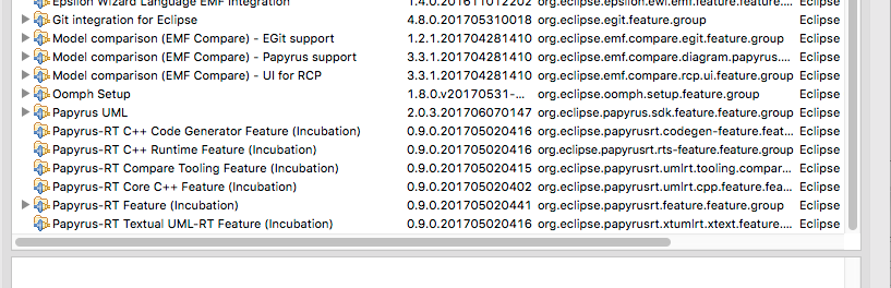

I have updated my tester version again, but it does not get the new version. My Eclipse is Neon3, Is this update available for Eclipse Neon as well?
I can not update my Eclipse to Oxygen because I have some plugins that are not compatible with that.
As you can see, My Eclipsed updated recently, but I do not see the last version.
index.php/fa/29584/0/
Re: setting * as the message of the trigger does not work properly (v0.9) [message #1765217 is a reply to message #1765211] Wed, 07 June 2017 11:19 Go to previous messageGo to next message
How exactly are you updating? With Help->Perform Setup Tasks? Manually with Help->Check for updates? With the Eclipse Installer? Some other way?
As for Neon v. Oxygen, sorry but we will no longer support Neon. We have moved to Oxygen which is the target for 1.0, and this particular fix was merged after we moved to Oxygen.
What are the plugins/features which are not compatible with Oxygen? If these are from products in the release train, you could probably find milestone update sites for their Oxygen release.
Re: setting * as the message of the trigger does not work properly (v0.9) [message #1765221 is a reply to message #1765217] Wed, 07 June 2017 11:53 Go to previous messageGo to next message
I used "Perform Setup Tasks", but my version is Neon and I think this is the main issue, I will try the Oxygen to see if it fix the issue.
