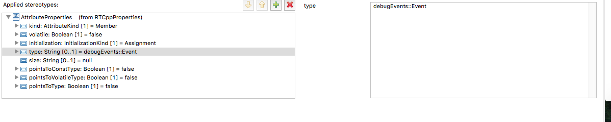

In PapyrusRT v 0.8, It was possible to use AttributeProperties and assign a type to the attributes which are imported using header files. For instance, the following figure shows that the type debugEvents::Event is assigned to an attribute.

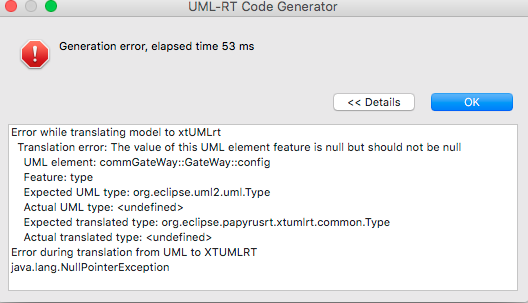

In the new version, using the same method raise an error during code generation which is shown in the following figure:
index.php/fa/29384/0/
Is a new way introduced to use imported type in v0.9? or this is a bug?

It's a regression. I've opened Bug https://bugs.eclipse.org/bugs/show_bug.cgi?id=516842 if you want to keep track of it.
