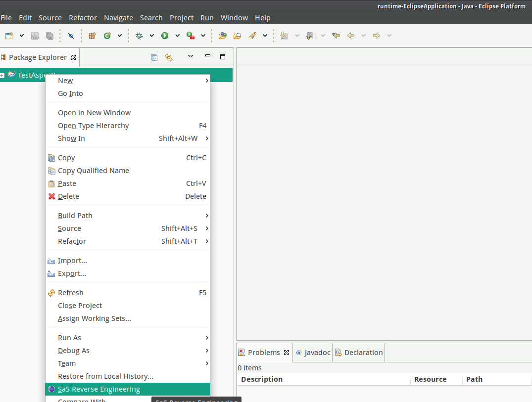

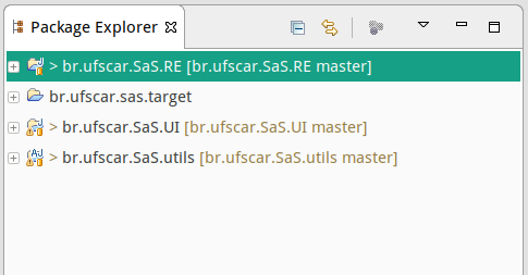

Where RE and UI are eclipse applications developed with SWT. So, to lunch the application the user chose a java project with the second button of the mouse and run my application by means a menu. The utils project is a plug-in that contains my aspects and target application has all bundles needed in order to execute properly my application.

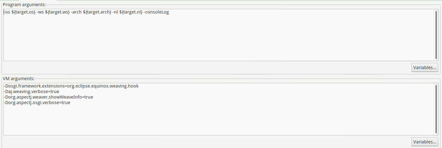

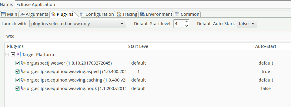

I performed all the configurations needed, for example,
index.php/fa/28996/0/
and
index.php/fa/28997/0/

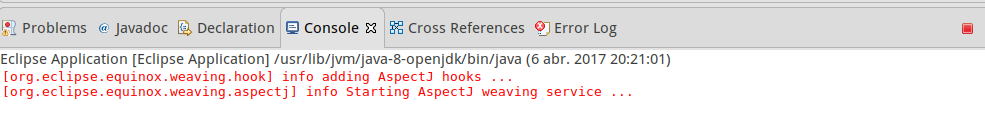

Then I try to run it, and in the console these messages are shown:
index.php/fa/28998/0/
So I think all is correct.

I got it!, it was a stupid error, in Eclipse-SupplementBundle, I wrote the package name instead of the bundle Razz
